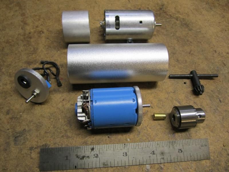

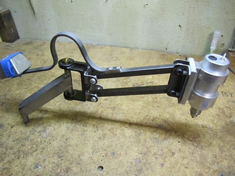

        • Saw this on Ebay. I have been looking for a small drill chuck and I do have a couple of the little Dremels but while they are very handy they don't seem to run as true as I'd like. A good chuck this size is out of my budget so I ordered this unit for $23. Out of the box it runs very smooth and quiet and it's also gutless. So I took it apart and replaced the wimpy motor with one I found in a box of RC car parts that came from yard sale. It has a .125 inch shaft that matches the original and the mounting screw holes have the same spacing and thread so it bolts right in. Very easy to get it apart.
          I had started this project and built it to hold an old Dremel, but when I turned it on I found it to have a bad armature. So rather than mount my good Dremel and having to make some changes to do so, I attached this little unit. For what I plan on using it for I think it will work just fine.

                    ...I ordered this unit for $23.
                    Ooooh, yeah! I want one. Was that a one-off or are there more available at that price Gene?

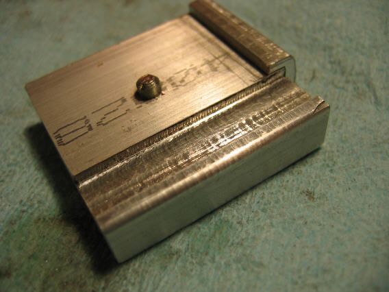

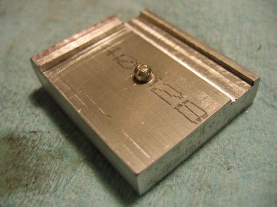

                          • So I did make the bending jig. That's out of the way now so I don't have to do it tomorrow.
                            Nothing fancy, its for an IXYS SIP rectifier. The pin locates the component by its mounting hole, the added edge orients it, the groove clears a protrusion on it (protrusion is sloped so that wouldn't orient it) and the leads are bent over the radiused edge. Previously made a similar jig for IGBTs.

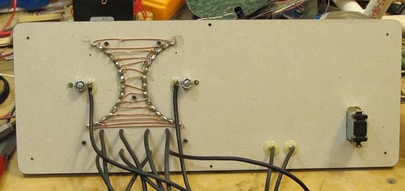

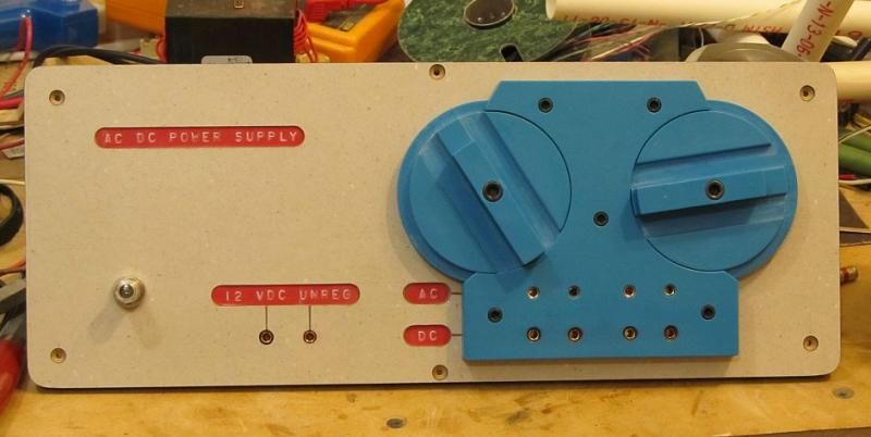

                            • Did some work on my power supply. Here's the front panel, front and rear views.
                              Lots of drilling, careful alignment, etc. I milled slots for the label tape to inset into, which I certainly like better than just sticking it on the surface. The two switches are 15 position, not marked out yet. Each switch has a spring-loaded ball detent for positive positioning, and I used the brazing strips I got to make contacts from. Each contact inserts into a drilled hole, then is epoxied in place. Once the epoxy cured, I filled the gaps from the front with ca, using baking soda as an accelerator. The contacts sit just proud of the surface, and a wiper runs over them to select a voltage. The rats nest of wiring on the rear of the panel will be about tripled once all the transformer leads are connected and the bridge rectifiers and filters are installed. Can't wait to be sorting that out
                              The switch knobs and the cover piece that holds the bandana jacks are made from pvc. Machines nicely but sure takes the sharp off HSS cutters. At any rate, I use several custom scrapers to remove machining marks- I still have to polish it up a bit.

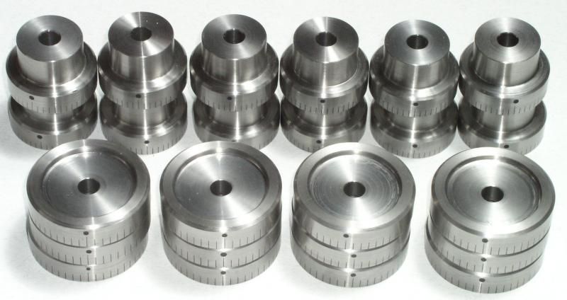

                              • I got this order finished and shipped off today.
                                [IMG][/IMG]
                                Stainless steel and I don't have a stout enough machine to make effective use of carbide so it was HSS tools. I don't mind the slow so bad as the miles and miles of stringy chips. Ugh.
