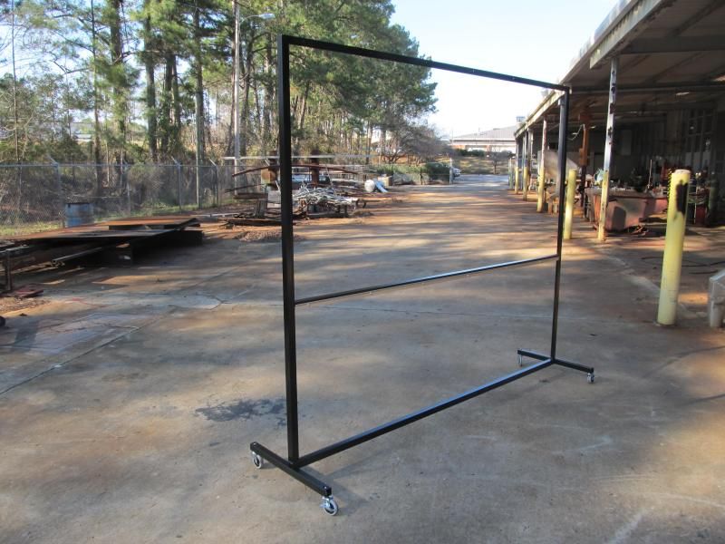

  • And here's the larger frame, painted and ready for the whiteboard.

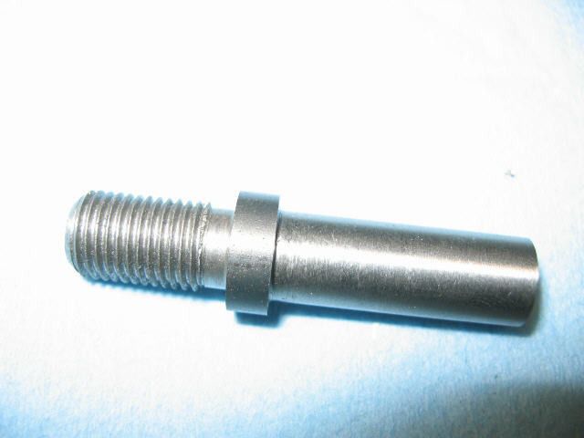

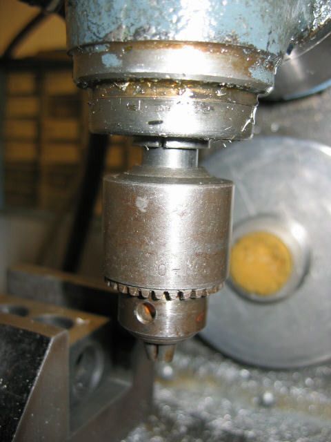

        In between going to friend's B-day parties, etc, made a small adapter for a drill chuck. Wanted to be able to pull out an end mill and slap in a drill chuck on the mill, to avoid having to pull the collet and swap in a chuck arbor. So made this to mount a small chuck for spotting drills etc in a 3/8 collet. May make another for 1/2" collets, I have several small chucks around. Mill uses MT2 collets, which have a reasonable length of grip.
        Made of 1144, it threads and turns very nicely.

          • Very nice. I think I'll make something similar for my Atlas when the weather warms up.

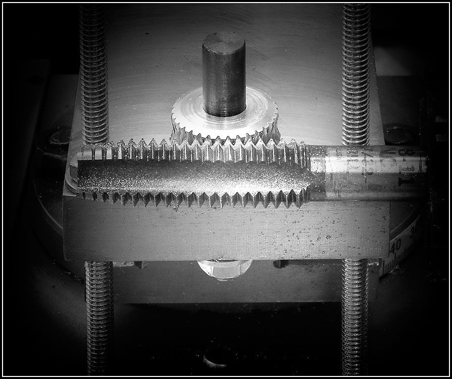

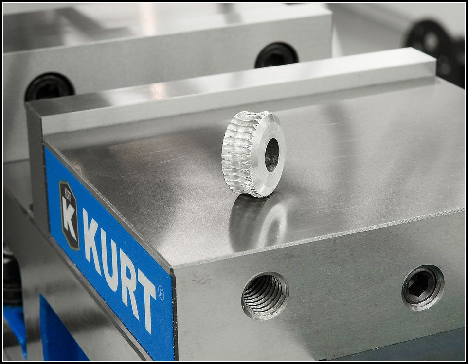

                  • Hi Guys,
                    I've completed fabrication of the worm-driven-gear fabrication fixture and I've commissioned it thus producing my first gear that I've ever fabricated. Many lathes have additional T-Slots located on the cross-feed base ..... as many as 2 or 3. My lathe does not have these accessory T-Slots. It would be a great advantage, I think, to have these additional slots BECAUSE I think that some fabrication fixtures would be far more stable and less subject to vibration. Not having these accessory T-Slots has required that I use the large T-Slot on the compound (having at least one advantage not present with accessory T-Slots).
                    The first order of business was to cut a piece of flat bar stock, 0.750" thick x 3.75" wide into varying lengths ranging from 3" to 6 ". In this case it required three varying lengths. The next order of business was to surface-cut all surfaces on the three plates to produce squareness. The next step was to TIG weld the plates to one another and perform a final surface cut to do away with raised welding beads; this leaves me with unfettered access to any smooth flat, square surface for indicating purposes.
                    Mounting holes were drilled into the fixture and adjusting slots were milled using a 5/8" endmill. A T-Nut was also fabricated to fit the large T-Slot on the compound. A 1/4" slot was milled along the midline on the "tongue" of the fixture for a distance of 1.5". This slot is used to connect a jig for holding the driven-worm-gear blank. At first I thought the fixture was sufficiently rigid thus no additional support was needed BUT, as it would have it, when beginning the first several cut, significant movement was observed so I drilled and tapped each corner of the tongue to accommodate 1/4" x 20 TPI all-thread dampening bolts ..... which did the trick. By running the drill rods down and allowing them to rest firmly against the base of the cross feed, this totally eliminated all observable up and down movement previously witnessed as the cutter swiped away at the blank.
                    My first ever driven-worm-gear was fabricated from aluminum having 33 teeth. The gear fits nothing; this was a dry run to check my math and to prove workability of a new fabrication fixture. Additional modifications may be necessary because setup is quite time consuming and most difficult to center the blank along its midline. Perhaps a special instrument for measuring height would prove most helpful.
                    Nevertheless, I am including images of the fixture, a blank gear being cut, and the final product.
