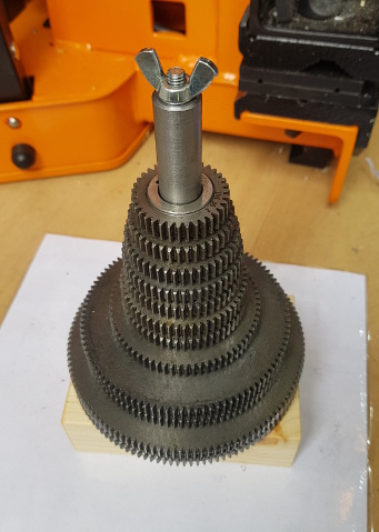

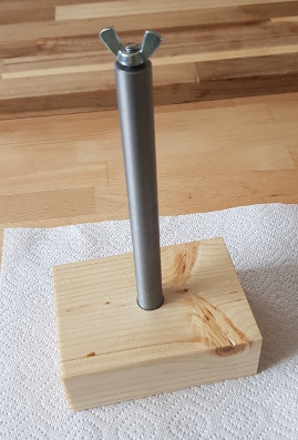

    • Got myself set up for a 1mm interference fit. Took some good use of my swing press (BF hammer). I should say that this was into wood....I'm not that ripped!
      Vacuumed up all the metal chips round my mill and started tidying. Obviously got sidetracked and ended up making a base for the change-gear storage shaft I'd made ages back. Now I have sawdust all over the mill to clean up.
      Hey-ho. Progress is progress....even though it's entirely non-linear and very scatter-gun between projects :-D

            I believe you have a wood shop so you probably have much quicker ways of doing it but in a pinch, a fly cutter with an aluminium profile insert makes a lovely job on hard woods. Works on soft wood too but needs a little sanding to clean it up - especially on the endgrain.
            That's how I cleaned up the scrap block of wood in this change-gear storage I threw together. I'd made the shaft some time back and not got round to any sort of base and it was annoying that you couldn't put it down without it falling over.
            • For a small piece like that I would probably hand plane it, too dangerous to run through the table saw or planer (jointer). Though the sides could be squared up on a sled or a slider table on the table saw.
