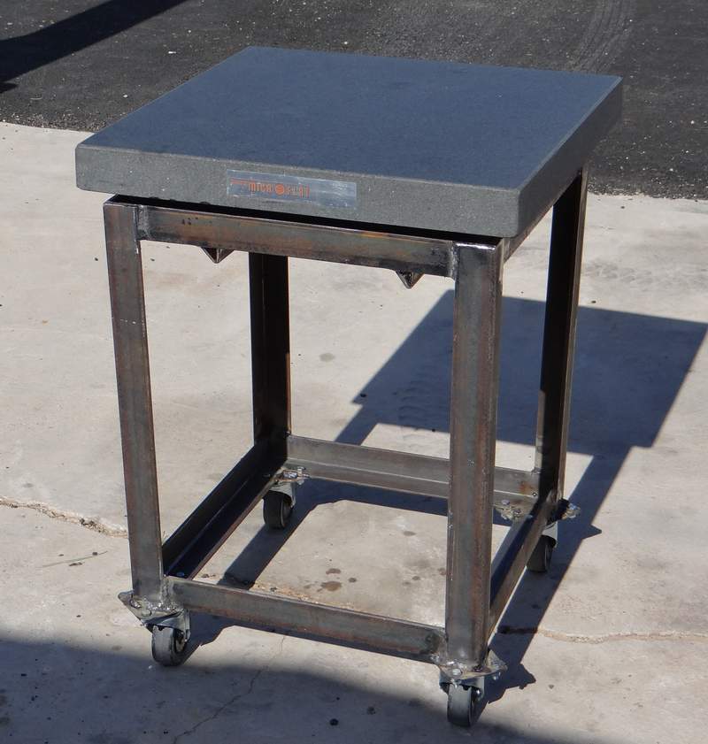

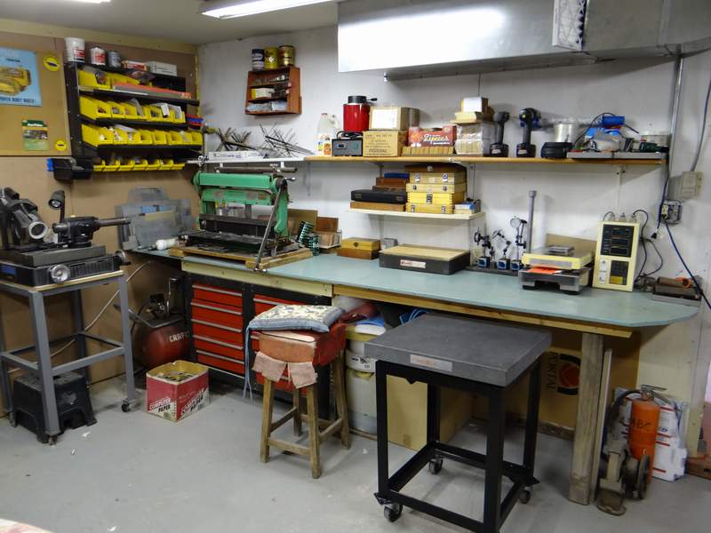

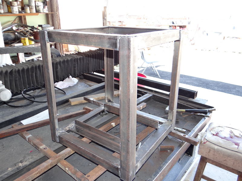

  • Welded up a table out of angle. The 2 extra angle pieces are for the pads on the surface plate.
    Finished unit just needs cleanup and paint.
    Fits nicely under my packaging / measurement bench.
    I will be mounting extra adjustable feet on the bottom for stability and leveling when in use.

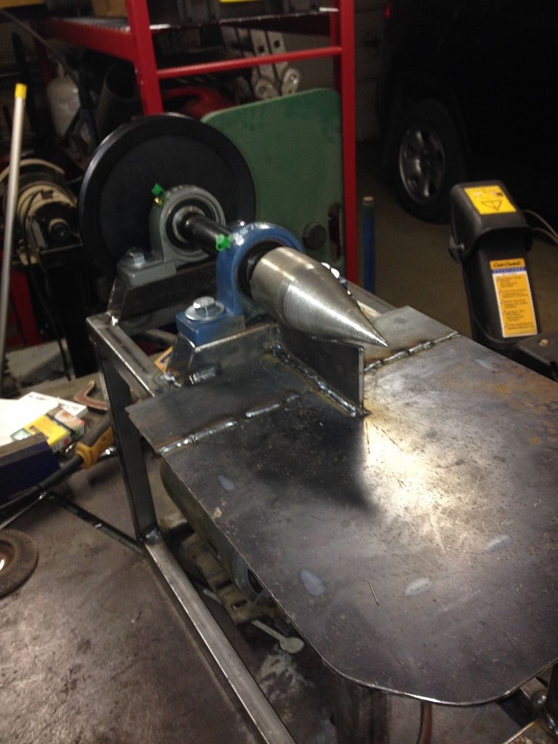

    • Small wood splitter
      Working on a screw type wood splitter. Threading the cone was a trip. Pic of work in progress.

        Nice work and score on the plate!
        My only gripe would be the ankle killers sticking out. At one time I had something similar on a table or welding cart or the like. After smashing my ankles into them twice was the end of that noise. Now I never build anything that has any sort of corner sticking out especially at ankle height.
        • It's under the bench now but when I have the time to actually use it I'll be putting a bumper with leveling feet on it.
          Right now those casters are nasty but I wanted a wide base so I stuck them out.

          • Bumpers are a good idea! As is a wide as possible stance especially for something that top heavy.

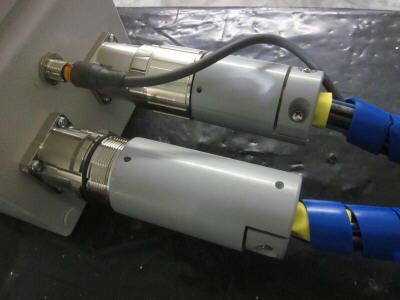

            • Wasn't today, but a few days ago, made these electrical plug bodies for a test setup.
              PVC material, drilled and bored out and variously cut and milled to make the clamps and retainers
              Nothing super exciting since, just routine stuff.

                      • Still working on the splitter, pretty stoked, had to recut the threads on the pointy end of the cone. Works good on 2x lumber so far. Have to find some real sticks to try.

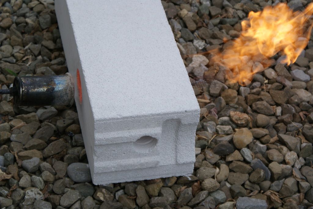

                              • my new hardening oven
