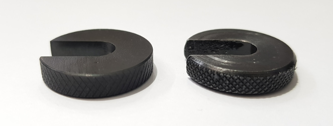

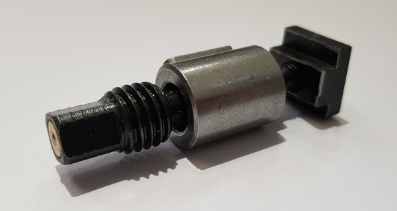

                    • Been trying to get change gears on my lathe to cut threads it wasn't supposed to. Think I may be able to do it by sticking another spindle on the banjo. Turns out they're available as spare parts for less money than I could be bothered to make it for So, one spinde, sleeve, key and T-nut through the post. Pressed in a 6mm oiler using the appropriate arbor press for the job *cough* bench vise *cough*
                      ...and then found that the only parts that weren't available as spares were the hex nut and the 'Pacman' washer. Nut turned out to be just a plain old M12. And the washer, well, have lathe; will make cylindrical parts! Even got to test out the scissor-type knurling tool I bought quite some time back. It's not as heavy as the original but it doesn't really need to be.
                      Had fun with the thickness though. Lined up the right-hand edge of the parting tool with the face. Measured the carriage travel with a dial indicator clamped to the ways. Exactly 5mm to the 0.01mm. Parted it off.....5.1mm thick. Hence the fly-cut surface as it wouldn't fit until it was slightly below 5mm.
                      Cold blued by the kitchen sink.....my wife just loves me! Definitely seems to take better on a rougher surface though. The knurl came out pretty deep black. The fly-cut surface is near perfect too. The other side I tried lapping the facing marks off and it's not quite a polished finish but it's pretty good. Blueing didn't seem to take so well on that though - slightly blue (ironically) in places and a bit thin in others.
                      Slotting went pretty well too...with more appropriate endmills. 4mm 2-flute TiAlN-coated carbide endmill and a 7mm slot. Came out bang-on 7.00 according to the digital verynear. Much better in the more suitable lower-profile vise too.
