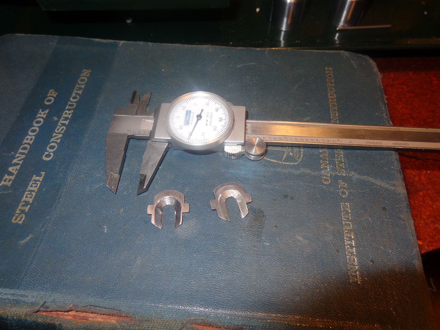

                  • Yesterday I made these two simple looking parts, which are slid over a shaft on a spring loaded assembly and used to compress the springs in a simple press so that e-clips can be removed and the part disassembled. I was quoted $450 to make the two parts by a local machine shop, so decided to make them myself. The simplicity of the parts in no way reflects the work involved in making the damned things. I STARTED with a 12" length of cold rolled round 3/4" steel. A 3/16" hole was drilled 1/4" deep in both ends. Then with the compound rest set over at 22 degrees, the shallow taper was put into each end on the lathe. Then, a 3" length was cut from each end of the 12" piece I started with. These pieces were stood on end in my mill vice, one at a time, and a 3/16" endmill was used to cut from the center hole to the outside. Then the mill vice was tilted 22 degrees off vertical, and the shallow taper was run up each leg of the cut, to merge with the taper put in previously on the lathe. Then the 3" lengths were set up horizontally in the rotary table. About this time, I was beginning to figure out why they had been quoted at $450 for the two of them. An end mill was used to make the 4 cuts on the outer edges of the 3/4" diameter. Now, I had the shape I required, but tell me, how do you part something off to be .070" long, in a severely interrupted cut, without everything going sideways? So--I used the bandsaw and cut a slice about 0.150" long from each of the "stub ends" that had the correct profile. Then I took a piece of scrap steel, and plunge milled a couple of 3/4" pockets .070" deep into one side. Then I plunge milled with a 3/8" endmill to take the "hump" out of the center of the plunged holes. (endmills do not leave a flat bottomed hole). The two machined pieces were then coated with Loctite and set face down into the two recesses and left overnight to set up. This evening I set things up in the milling vice and milled away any material that stuck up above the scrap steel. The scrap steel was then taken out to the main garage and heated up with the oxy acetylene torch until the Loctite let go and the pieces could be popped out and cleaned up with 220 grit paper. The parts are a success, and i am sure my customer will appreciate them. All I have to say about the entire operation, is that this is about as close to wiping your arse with your elbow as I ever want to get!!!---Brian
