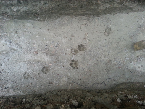

                When we poured the concrete for the office at the bottom of the garden (that's it, no more space) the cats we had at the time 'signed' it....before it rained and turned it into a moat.
