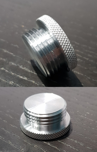

                            • Had the day off with my son today as part of the school holidays. He was supposed to be making a bird feeder for Cubs (younger Scouts in case it's called something different elsewhere) and the instructions involved getting an empty plastic bottle. Yeah, I think we can manage better than that! So I drew up a 3D plan in Fusion in the quiet spots of worktime yesterday. We now have two Delrin discs ready to have some wire mesh slotted into them. Only issue was that I chose a large threaded cap for the top - larger than any tap I have...but it needed to be able to have peanuts poured into it. We've got the bore done but it dawned on me then that I'd really need the male threaded part to offer up to know when it fits. So I reluctantly took it out the chuck and started on the cap which is in alu.
                              Some of the figures I'd got from t'internet turned out to be a little off and I ended up getting the wires out when I hit the bottom of my undercut but clearly hadn't finished the thread. Wires are imperial with a metric conversion sheet. Go look at Machinerys Handbook for the thread specs it said. Ha, I laughed...I've actually got one of those now! So I duly thumbed through it and the metric threads on offer are M24 and then M27. Obviously the idiot designer had picked an M25 thread as it fitted in the hole I could have gone with the formulae...but, and I'll be honest here, I really couldn't be bothered. So back to Google and some swearing at juggling three wires and a mic later and we have a thread.
                              Top of the cap is knurled. Bented I found a great lubricant for knurling. The bristles off the acid brush...and half the stem of the brush too. Must have been good because I managed to feed it another couple of brushes There was some restrained colourful language! I think I'll work out some way of dripping it on instead of a brush next time! I also suspect that 30mm diameter may have been at the limits of what this clamp-style knurler could manage. I'll definitely be taking the knurled (there's an irony there somewhere) nut off the clamp and running it through the mill until it has a nice hex shape I can stick a socket on - or a spanner but I think a socket will give me the clearance. This should mean I can stop trying to make it tighter by infeeding the cross-slide....which seems to result in the QCTP rotating slightly. On the plus side, no wheels exploded so I'm calling it a win!
                                You had enough sense to let go of the brush, right?
