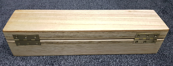

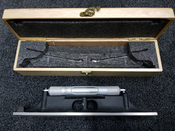

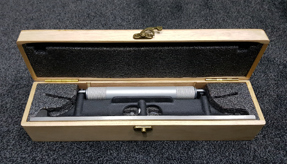

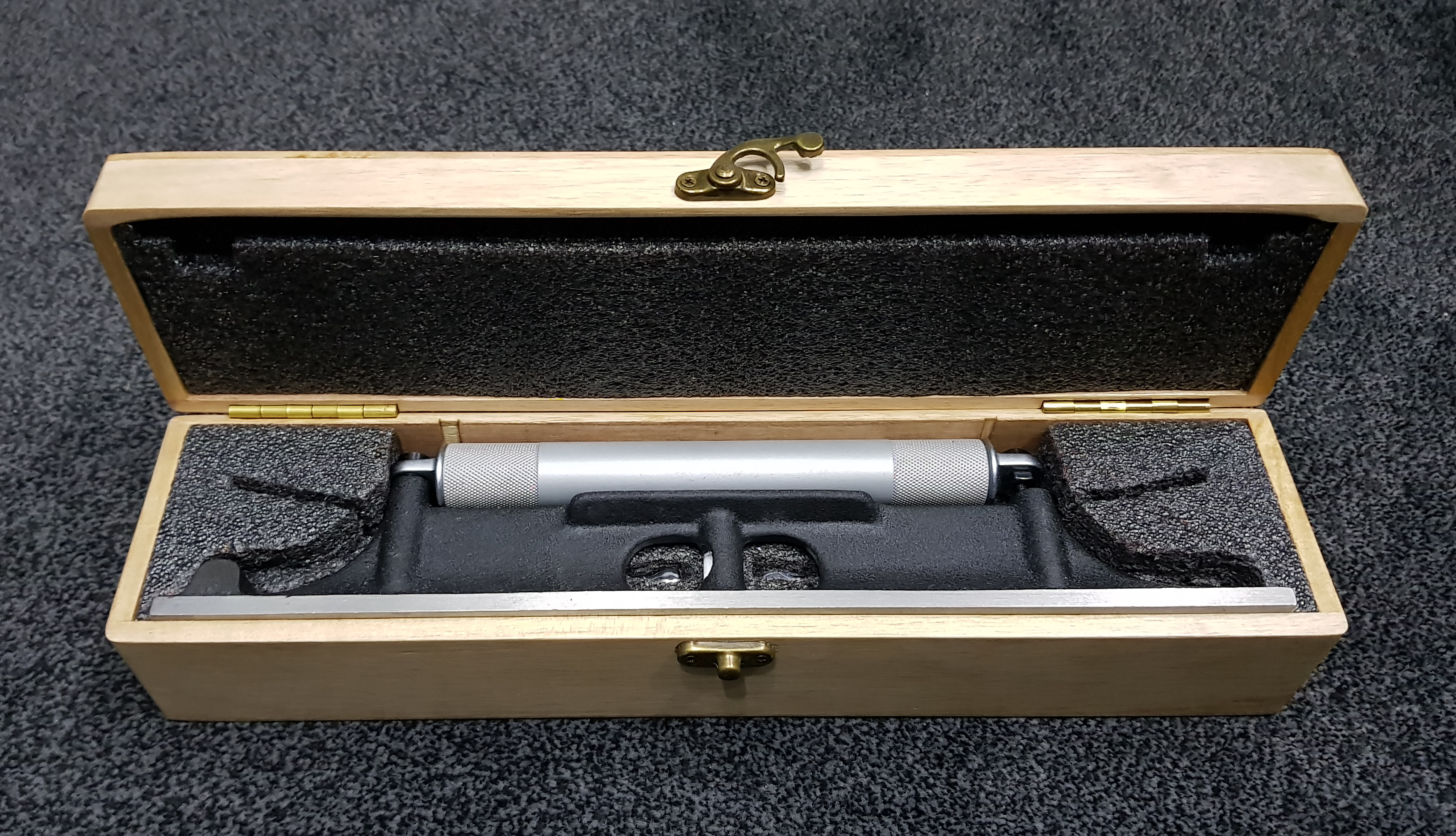

                            • Well, inspired by Tim Clarke and his case for a level I went in search of something a little lazier to do mine. As these things tend to, in being lazy I probably made more work for myself in the end! I found that a 12" level is about the size of a bottle of wine so I bought a presentation box from Amazon. It's a little lighter than I'd like but actually for what amounts to about $12 including (slooow) shipping, it's pretty good. The hinges weren't screwed on straight so it didn't open particularly well. Good enough for it's intended one-shot purpose, I'm sure but I replaced them with some slightly overkill brass hinges, cut them in and reverse-mounted them (didn't want them to stick out and didn't have enough wall-thickness for a flush hinge) and lapped them in It would have been nicer if I'd got the screws in true but these things are tiny (5mm head and 6mm long)....and I'm an inept wood-worker!
                              The stuff inside is Kaizen foam. Unlike Tim, I made cut-outs on both sides for the transverse vial. I'm bound to try shoving it in backwards otherwise and the foam's a little less rigid than his oak!
                              Even found enough space for the pair of 3/8" spanners required to adjust it - I don't have any other use for them so they live with it.
                              You can see the couple of grooves I cut (badly) to accommodate the mountings for the vial.
                              The box came unfinished so I've coated it with a number of thin coats of Osmo TopOil to give it some chance of surviving the shop environment! I did try asking Osmo whether it was known to cause/accelerate rust and they rather helpfully informed me that contact with rust shouldn't harm the finish
                              • Nice job! I'm thinking that I'll try foam for the next case I make.
