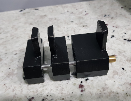

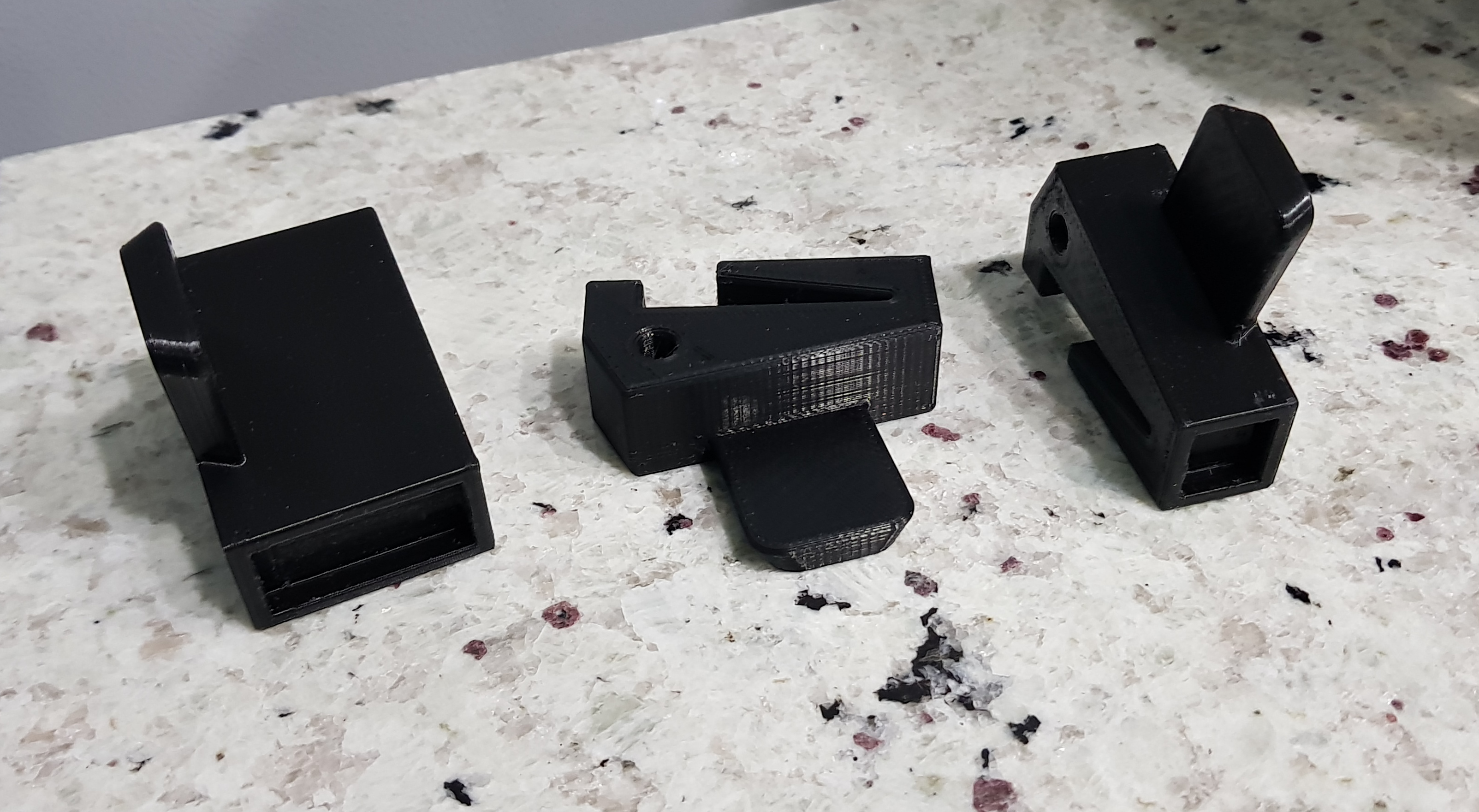

                              So, this is what I've been up to (amongst the usual) for the last few days. My lathe QCTP tooling is insecurely hooked (by the dovetail ) on the splashback where they can nosedive into the chiptray on a whim. It's also overcrowded. I've been dabbling with the whole 3D printing lark for a while so I made these (and many more) to fix the problem.
                              The recess (you can see on the left one) is just "storage". Tiny but thought it might be useful for the odd spare insert - may as well use the space for something and it didn't feel right to try to add drills or something like that in the design.
                              6mm through-hole was printed at 6.25mm (yeah, my dimensional accuracy isn't all that currently) and then reamed to size because I have that luxury. I was thinking of a rod screwed through the sides of the splashback but I might just go with dowels for the moment - I have some lying about, they seem to work fine with just the weight of the other holders and it means not drilling holes.
                              One inverted (for boring type tools), one standard and one extra wide for my boring bar holder. Also did an extra wide for the Morse 2 taper holder. These are all for import 000 size QCTP by the way.

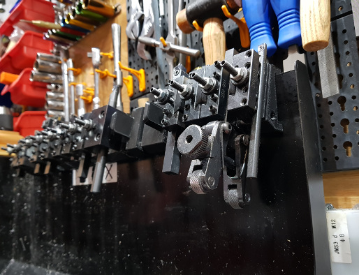

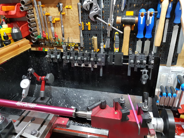

                              Fitted to the splashback.....well, dropped in place for the moment. I'll add the dowels once I've decided where each should go. Also in view is evidence of a repaired tailstock casting Got it to less than 0.01mm front to back but in the up/down plane it's at least 0.07mm out and not easily adjustable....but that's another issue
                              Tidy
                                Very nice.
