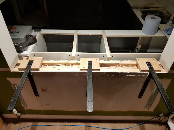

        Pic of the late-night bracket support blocks I milled (slots and reliefs). Today there is sawdust in my shop to clear up.
