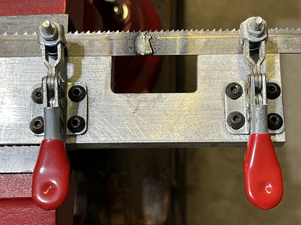

                            • I successfully silver soldered my first band saw blade repair. Put 20 deg angles on the opposing faces, crushed the solder to a flat wafer and used a little butane torch. Most of what you see there is flux. It cleaned up nice and bends well. Got 6 more to do…

                                Use this one a bit, to be sure that you were indeed successful. No sense doing the others until you know that you're doing it right. I never could get it right as much as they looked good.
