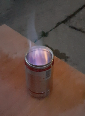

      • Set fire to things! (safely)
        (Video)
        Why? I wanted an air tank and they go for north of £300. A refurbished CO2 fire extinguisher was £23 including delivery and is rated FAR beyond the 8 bar I'll be using it for. Just need to make a new top for it now. Also, it was good fun and useful practice - if you ever have to use one for real, you ideally don't want it to be your first time!
