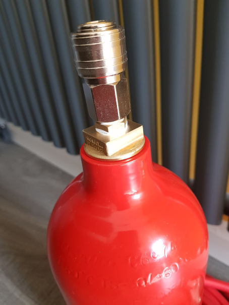

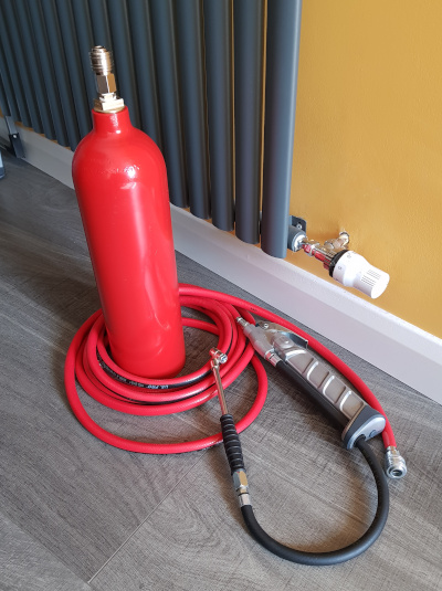

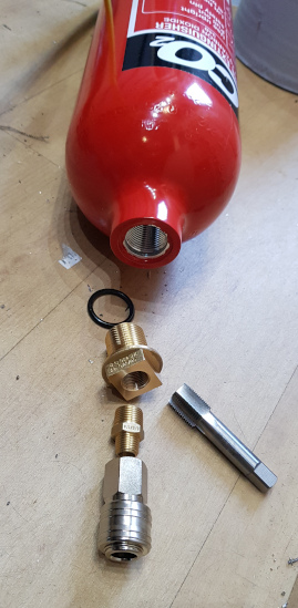

                            Finally got the G3/8 BSPP tap delivered that I'd been waiting for to adapt the neck to pneumatic fittings. Sawed the top of the valve off, machined it flat and bored the hole out to 15.25mm (metric equivalent of tapping drill for G3/8). It was already 15mm, hence the choice of G3/8. That and that I could buy a brass G3/8 to G1/4 convertor and not be tempted to buy a big chunk of brass to make the whole thing from scratch
                            Assembled with 3 turns of PTFE. May switch to Loctite once I'm happy everything is going to stay as it is but I wanted to be able to change my mind without the clean-up. Also wanted to test it before the Loctite would have cured!
                            Worked nicely checking and topping up two sets of car tyres. Need to get the bikes back on the road tomorrow so we'll see how many totally flat tyres you get out of a charge! Beats trying to lug the compressor through the house or getting grief for running hose through - probably cheaper than that length of hose too!
                            Just need a ball valve in my male-to-male connector that fills it - disconnection's a bit loud otherwise!
                                Well that just absolutely takes the mickey! Got everything charged and set up this morning. Got the bikes out: one of them has Schrader valves....and perfectly inflated tyres (clearly my first every tube and tyre change went well last year!) and the other two that are flat as a pancake....are Presta valves So back to the foot pump it was. At least I'm not quite as unfit as I feared!
