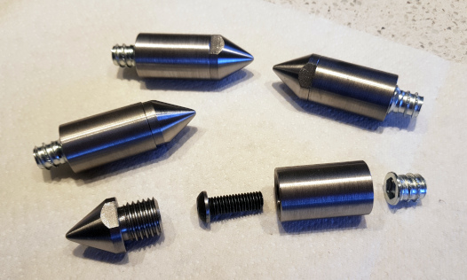

          Made feet for a friend's speaker cabinet that he's building and veneering. These are in EN8 as that's what I had lying around in the size - aka 1040 I believe. I said to him that I've made 19mm AF flats to adjust the length to prevent rocking. Presumaly you have a 19mm spanner? Apparently he doesn't and always uses adjustables. Am I allowed to demand their return?!

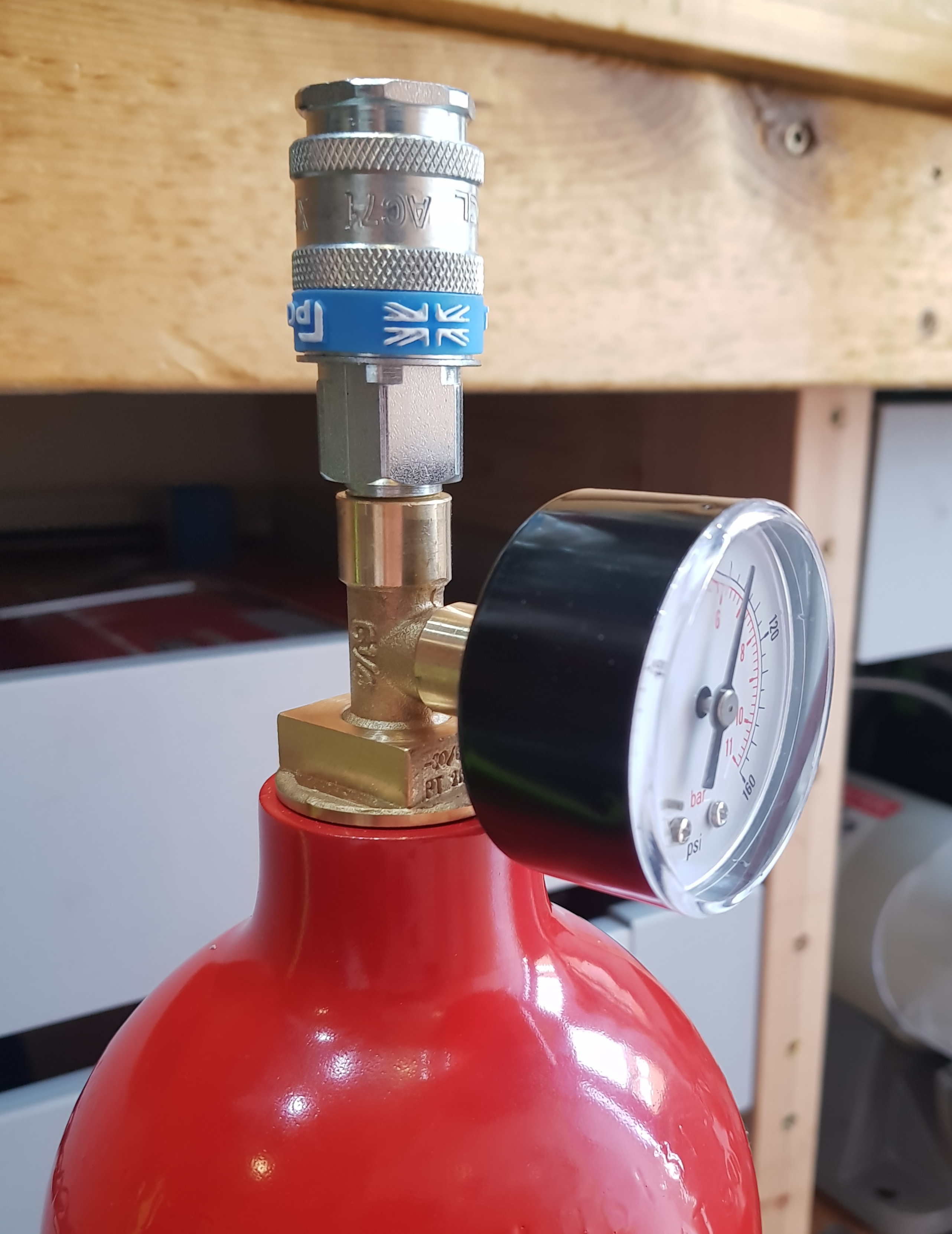

          Also tweaked the design of my air tank once slow-delivery parts arrived. Assembled it with Loctite this time and it's lost no pressure at all in 48 hours. Not a strict necessity....but nice to know that I did better than Hyundai managed on my compressor!
