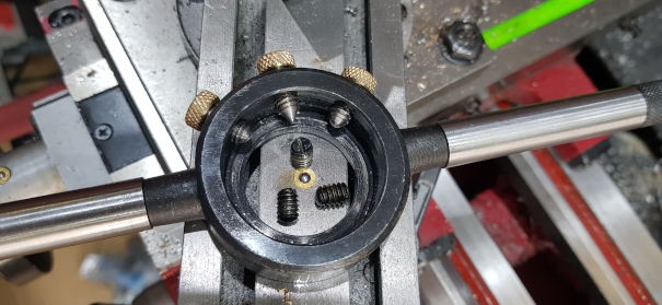

              • I've been using some of my larger dies lately - I say large, I think they're only an inch and a half but they're larger than my tailstock die holder or the die stock in my set will take.
                The die stock I have isn't bad.....but the screws are AWFUL. Proper cheese-steel, require a screwdriver to (un)mount a die and the slot isn't ever centred on some of them. So, I made these for it. Why two-tone? Well, most likely due to over-thinking if I'm honest. Brass was (in my head) too soft for the tip of the screw so it needed to be steel...and therefore some strong steel. So these are EN24 (similar, if not identical, to 4340). I thought that'd be tough to knurl so that bit could be brass and then I glued them together with Loctite 638. Lesson of the day is: make sure you've thoroughly cleaned any Loctite off the threads before you screw them in! Luckily I just got away with it before it went off like rock.

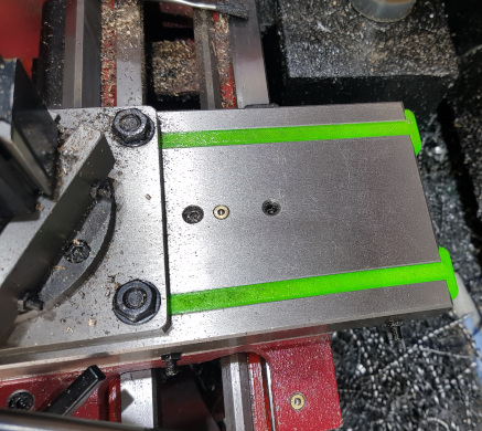

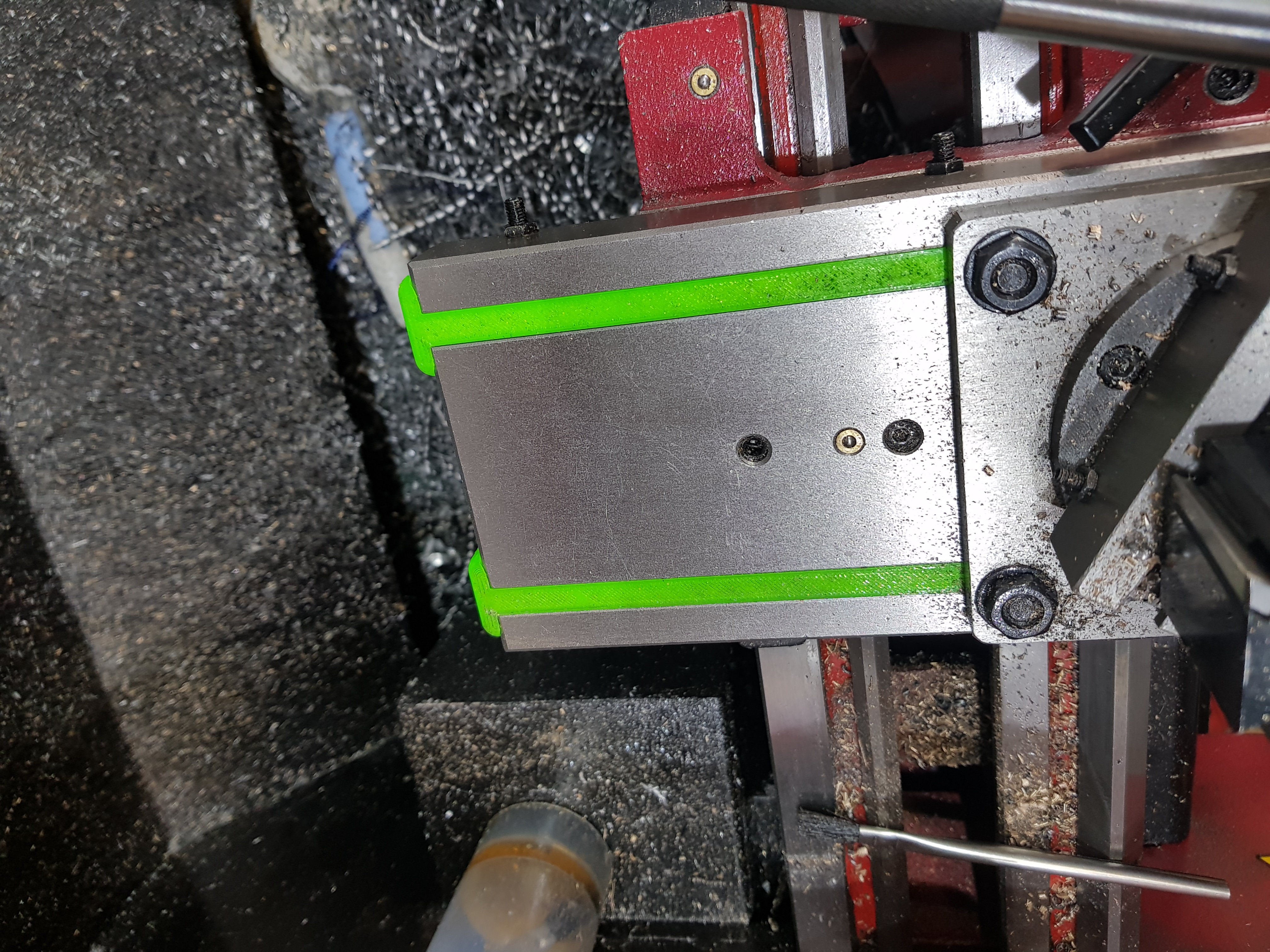

                Also been 3D printing some T-slot covers to keep the chips out. Why the delightful shade of green? I was printing some extraction adapters from a Festool extractor to a Bosch Click & Clean tool and this is as close to Festool Green as I could easily find.....and I couldn't be bothered to change it out for black. They work identically well though
                • Nice! I have a couple with the little flat heads too. you may have just given me an idea of next weekend's project. I think the green and red go well togetheršŸ˜
