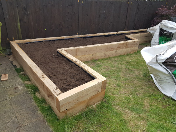

                              I posted the start of a raised sleeper bed a week back. Well, it's now finished:

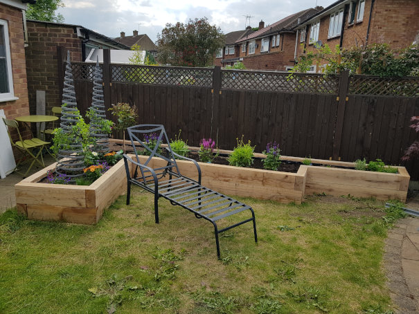

                              ....and planted! A couple of taller bushes to come for the back yet but definitely an improvement!

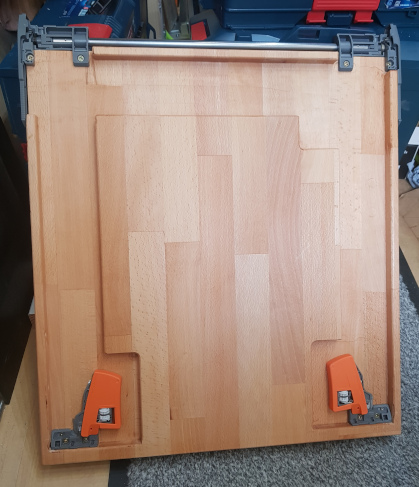

                              The other project that's been sitting on my 'to do' pile for far too long is a pull-out worktop that I planned when I added the drawers under my workbench. The underside needed to be routed out to take the slides (helpfully not actually IN this picture). The odd shape of the void is because I managed to mix up my width and depth and start 90° out. Ho hum, nobody will ever see it...unless I'm stupid enough to post a picture of it on the internet!

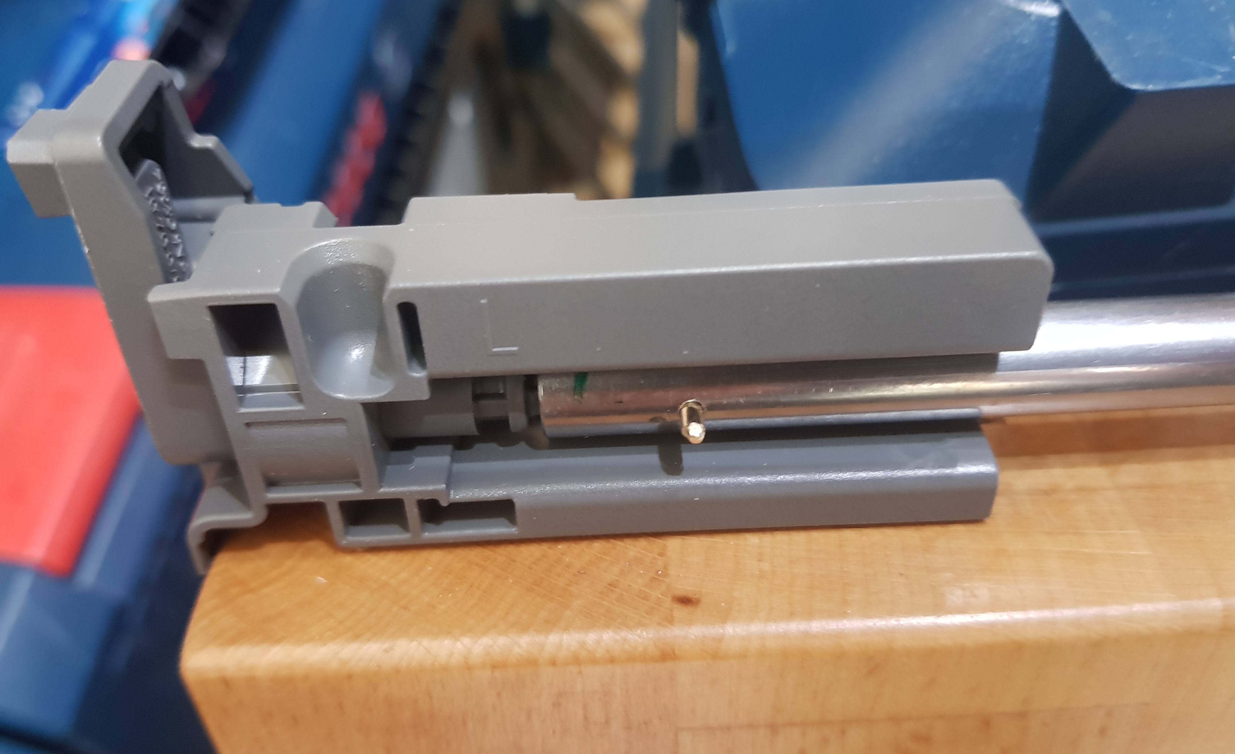

                              The shelf latches in the out position until you pull the two handles. There is a sync bar at the back to connect them so you only have to pull one. Problem is they sent what looked like the correct bar (round with a 4-way internal spline) but it was a fraction the size it should have been so wouldn't fit. Decided I ought to be able to cobble something together rather than deal with trying to get a replacement part months after the fact. Some steel tube of miraculously close ID and some 2mm brass rod as a pin and it's sorted.

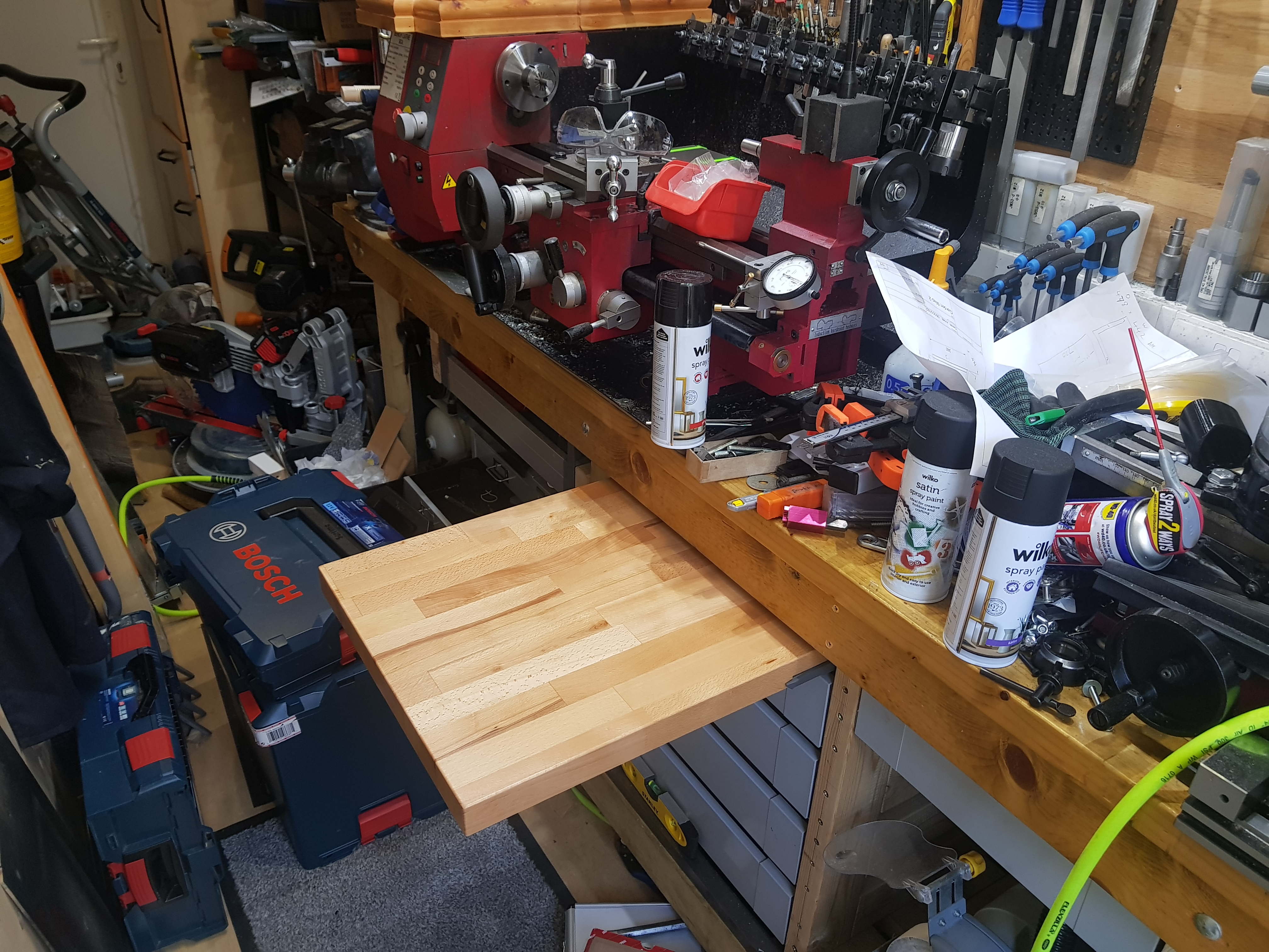

                              Now I have a new thing to get in my way when I'm trying to navigate my treacherously untidy workshop! A lot of that is the tooling for the sleeper beds...but I'm not going to claim that it's tidy even when that's been put away!

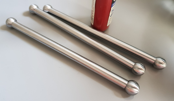

                              Last up was a set of four tommy bars for my neighbour's new pipe clamps. Clamps were good but the bars were hopeless. These are EN24 (4340) and the ends are soft ball bearings drilled and tapped M8. There's only three in the photo as I tend to make a complete one and then repeat. I'd end up with four that don't work otherwise!
                              Had a great time with the follow rest trying to turn 10mm bar down to 8.4mm to fit the clamps. Probably would have been easier if I'd not decided there should be two bars at 300mm which I then cut in half as it should have been four at 150mm each!
                                The other project that's been sitting on my 'to do' pile for far too long is a pull-out worktop ...
                                We could start a pool on how long before that pull-out is as piled-high as the bench😉
