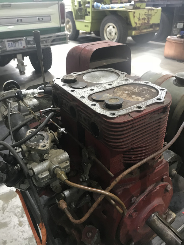

  • Made up some linkages and hit up the scrapyard for some parts to make a runner.
    Got it spinning, a lot of afterfire and some backfire. Found the exhaust valves stuck open (common in this motor)
    So now it seems the timing is 180 off or maybe 360 as the intake sounds like the exhaust. Switching the plug wires gets the puff out the exhaust. More to do

    • Ok running like a top, I have to time it, cut shaft for pto and add a generator circuit

        • I hope that crack in the fins does not extend into the exhaust port.
            It doesn't look like a crack to me, it looks like cosmetic casting ridges from the mold to me.
            • Could be, and I thought so at first; but it looks like a section of some fins further back is missing. Maybe the block took a hit at some point breaking that section off, and possibly causing the crack. I hope you are right. My eyes are not what they used to be.

              • Originally posted by 3 Phase Lightbulb View Post
                This would be my guess as well. If you look closely you can actually see the casting line extending down underneath the ridge into the remaining fins.

                • Well, my mistake. If it's running like a top, it must be casting flash and not a crack. Just call me Debbie Downer.

                    • Will look, didn’t note a crack and runs well
                      Will follow up
                      • It's just a mould flash/misalignment from the mould segments that allowed the inlet and exhaust passage cores to be placed. Much the same as the one where the moulds were split to allow the cylinder cores to be placed.
