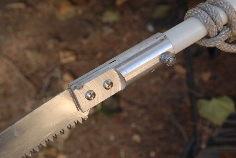

    • Made an adapter so I could replace the horrible saw blade and pruners on my Fiskar pole saw with just the blade off an excellent hand saw, a Samuraii Ichiban. I had some 1-1/2" diameter aluminum bar which I cutoff at 4-1/4" long, turned down to 1-1/4" diameter, bored a hole 2-1/4" deep to accept the 1" diameter inner sliding tube of the Fiskar pole saw. Using a fly cutter I milled 3/8" off each side of the blade mounting area to reduce weight and allow me to reuse the screws from the hand saw. Then I slit it on the bandsaw, match drilled the blade mounting holes, and then the hole to also match the retaining bolt in the tube on which it slides.
      This new setup is way lighter and cuts like butter.
