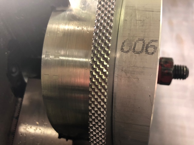

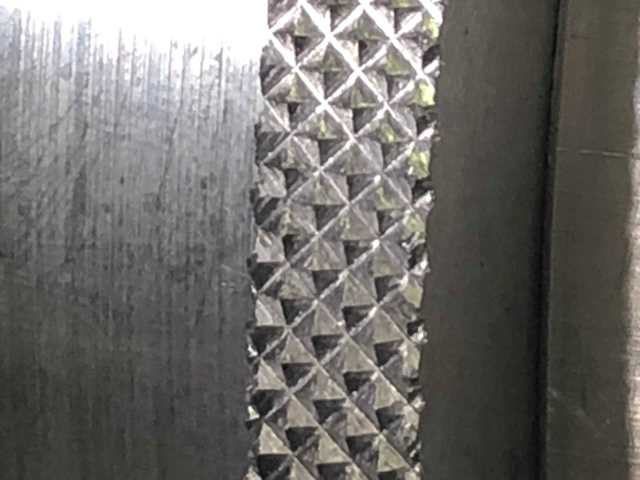

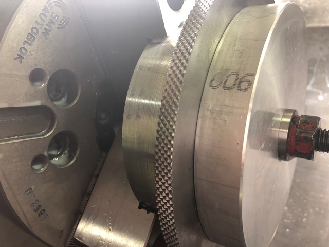

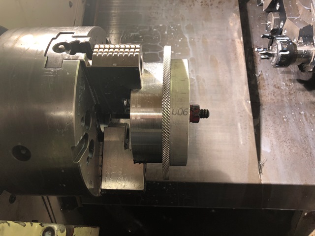

            • Knurled a few hundred pieces of D2 material, in three diameters. Was actually a lot easier than I expected it to be. Okay, that's an embellishment. It was shockingly easier than I expected it to be. Nary a hiccup and perfectly formed pyramids. Shop made tool. $30 and 1 hour of time. Maybe $35 if one counts the lump of material from the shelf.

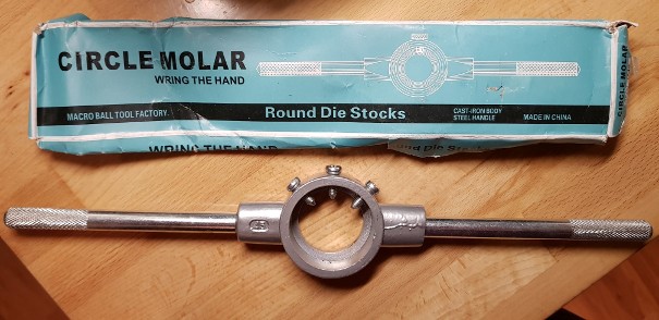

              • Bought myself a cheap 45mm diestock holder for a cheap G1/2 tap I've got that's bigger than any of the holders I have....obviously. Naturally, I found - just after I'd hit 'buy' - that I didn't actually need it....but that's a different story. It turned up this morning and it's Chinese-made, of course, but it seems to be quite good. No awful stink of oil that's seen a good 100,000 miles round the factory supervisor's car first. No oil apparent at all to be honest....and yet, no rust. Set screws have a Pozi head, aren't made of condensed schmoo and a decent looking cone point on 'em too. Could it be that European manufacturers are claiming 'made in China' for the cheap sale but failing to imitate the low quality sufficiently?!
                Anyway, thought you guys may appreciate the "English" on the box. Don't forget, "Wring the hand"!
                  Is there some secret reason why you bought a dieholder for a tap? Is the next project a 45mm round slug with a square hold filed in it?
                  • The knurling pics.

                      • Originally posted by reggie_obe View Post
                        Yes, it's because I'm secretly incompetent. Shhhh! Don't tell anyone!
                        I may get round to making some of Abom79's tap holders (round stock, through-bore sized for tap shaft and then slotted across the top to make a square-ish hole that holds the tap's square) but this was for a G1/2 die. In the end, entirely by chance, I discovered that the Frankenstein thread I cobbled together (something like an undersized M21x2) was a close enough match to G1/2 that it engaged for three threads; which was enough to retain the collar and seat it against the flat washer. Certainly good enough for connecting a hose connection onto a child's slide!
