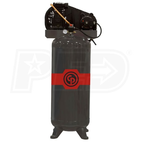

                  The Chicago Pneumatic 3.5-HP 60-Gallon Dual-Voltage Single-Stage Air Compressor RCP-3561V has been discontinued. Check out Expert's recommended alternatives for another top single stage air compressor.
                  What do you guys think of this one?

                      Kibby I can't see the specs on that one and normally like CP stuff but that one at a glance makes me very suspicious.......looks like possiblt a rebadged China setup, small 3450 motor and if they're inflated claims are usually the case a 3.5hp motor is more like 2hp in reality.
                      Where is radkins when you need him..........LOL
                      For reasonable dollars you are probably going to end up with a China setup but there are better out there.......try HF or Tractor Supply for their offerings.
                      This doesn't thrill me as the motor looks suspect (22 amps is more like a real 3hp) also but if their cfm claims are real????
                      Harbor Freight buys their top quality tools from the same factories that supply our competitors. We cut out the middleman and pass the savings to you!
                      Even with the iconic IR label it looks like someone else has added ingredients to this one.......
