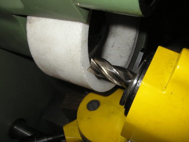

                            My one is a Deckel copy. I sold my universal T&C, it took up too much space and I don't need to sharpen cutter flutes or side and face cutters or grind special reamers.
                            Normally, it has a tapered cup wheel fitted and this is what I use it for :-
                            Sir John, this is how I get round the problem of cutter end sharpening, I work from inside a straight cup wheel, no angular limitation or space problems.
                            IanR
