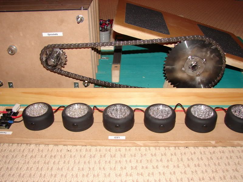

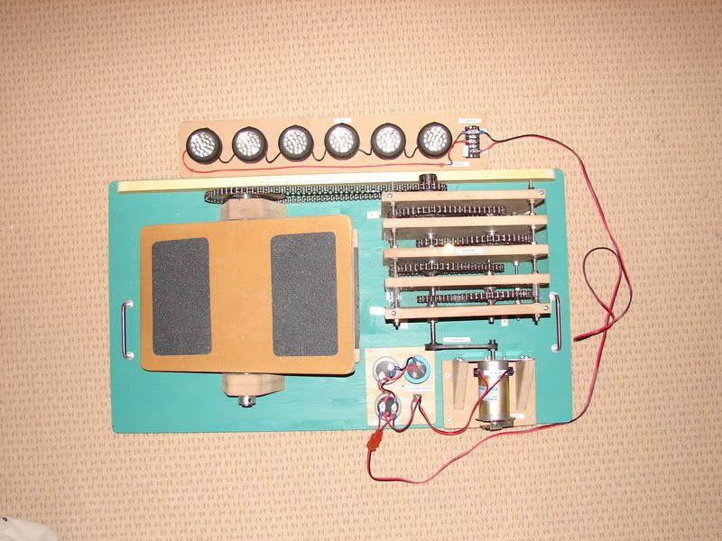

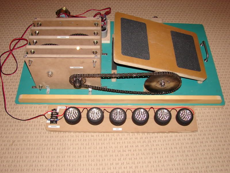

    I've been spending the last few weeks helping my 13 year old nephew on a science fair project. It was a good opportunity to teach him basics of machining, welding, and woodworking. To make a long story short, here are the pictures of the finished product. It's a portable human powered generator. Because this is just a proof of concept, the portability hasn't been demonstrated. When the teeter-totter is rocked at about 1 steps/second, it products about 8W which isn't that bad. It's definitely enough to charge a cellphone and light up 144 LEDs very brightly.

      Rotate that is a great project to learn from and I am sure your nephew learned a lot. The drive system looks good too. Looking at the pictures I assume the bridge rectifier is because the motor (generator) direction reverses as the teeter totter rocks back and forth and the bridge keeps tho output polarity constant. Is this right?

                Give that poor kid a flywheel! Very nice project.

                  I know what you mean. First of all, no science fair project of any quality is done without a mentor. I made sure that I spent many many hours going over the theory of welding, mechanical design, and electromagnetic theory. He know how everything works from how MDF board is made to Faraday's theory. I went over the design and demonstrated first what to do, and after that he did all the work under my supervision. The reason why everything looks so neat is because we planned very carefully and I made him redo anything that wasn't exactly to the plan. I would say that at least 80% of the work was done by him. It helps to have a child who's eager to learn.

                      It was my nephew that I was helping. What I didn't show was all the experiment that he did using the device and the result was posted on the display board.
                      The hypothesis of the project was to determine whether a portable human powered generator can generate enough electricity to charge portable electronics (in an effort to offset carbon foot print), and also provide power to rural villages in developing countries where CFL/LED could be used to light the homes. Unfortunately in 2010, almost all science fair projects have to have some environmental or social slant. Sigh...this was definitely not the case when I enter science fair in my high school years. We were allowed to building things just for the sake of the technology.
                      The power output was determined by submerging a resistor (load) in a known volume of volume (in a thermos) and measuring the rise in temperature. He did this with different loads and different rates. Lots of graphs and tables were obtains, which lead to the conclusion that a portable generator like this could indeed be used to power portable electronics and using battery light number of homes.
