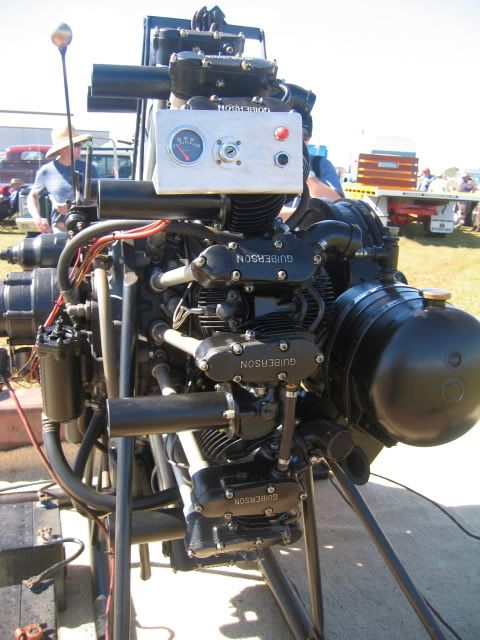

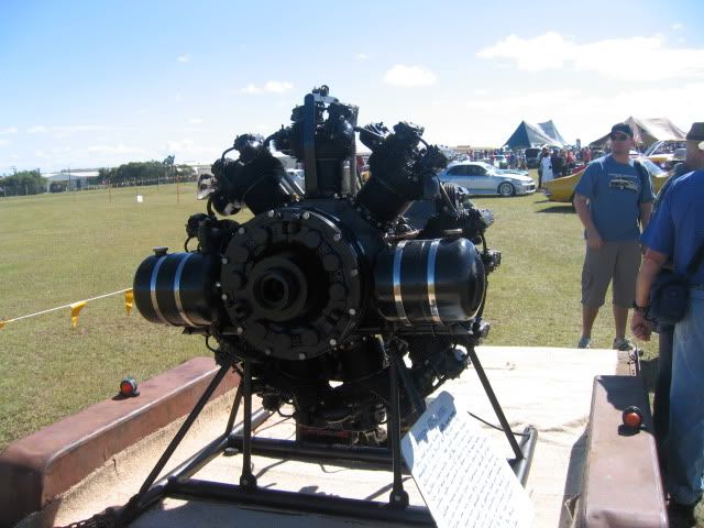

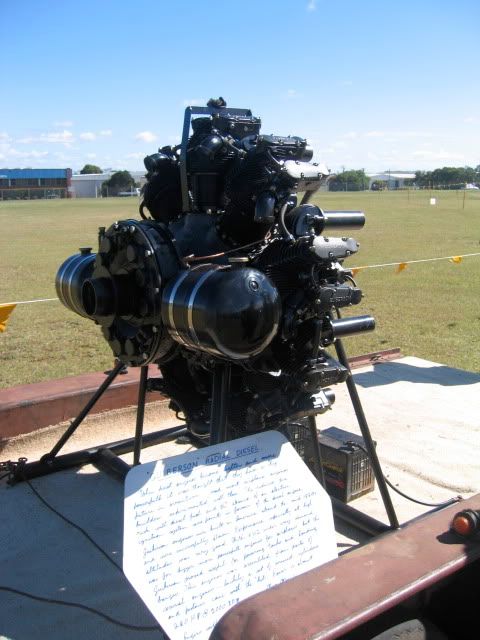

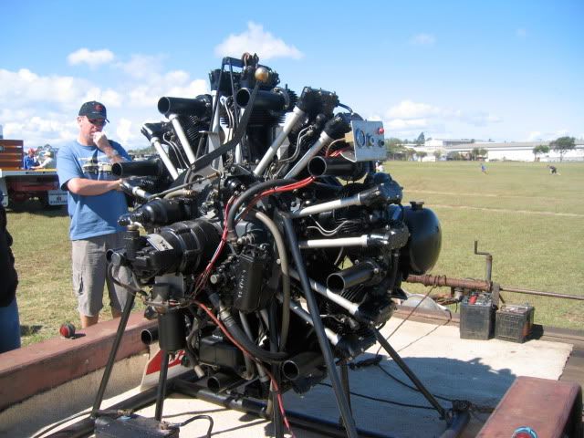

    This interesting Guiberson 9 cylinder radial diesel engine from the early 40's was one of the exhibits at the recent David Hack Day at Toowoomba, SE Queensland. From a little googling, I gather these engines ended up in tanks and boats as well as aircraft. There is a good article from the period here. http://www.enginehistory.org/Diesels/Ch3.pdf
