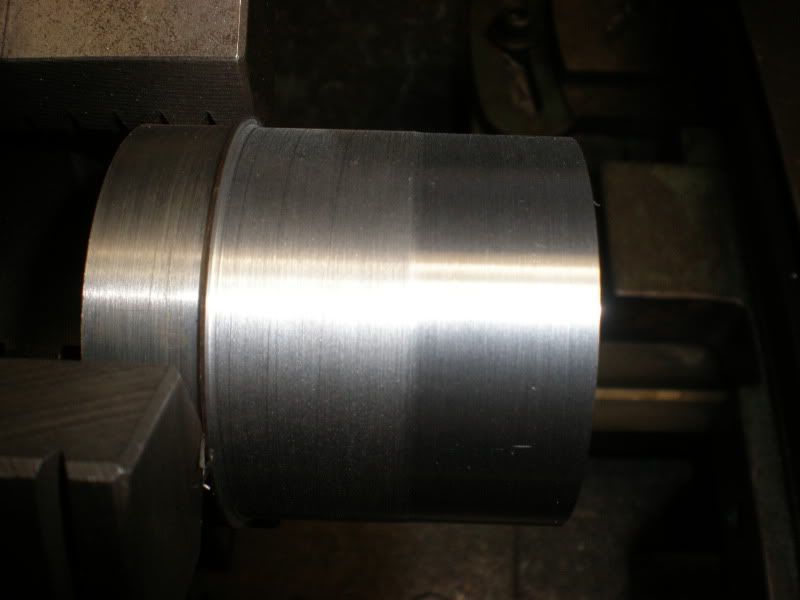

    A few weeks ago I received my Winberley Tool Holder. After I read the instructions I started making some cuts. It does everything he claims and will be very handy for those that use HSS cutters. His simplified method of using a drill bit to get the cutter tip on center line of the work is very handy and easy to do. Sharpening the cutter is easy especially with a good tool grinder.
    Much of what most of us do is turning the OD and face work so this holder is good for that without having to change tooling. When I am making a shaft with a shoulder I will rough it in with standard tooling and then use this holder to finish the OD and the shoulder face in one or two finish passes.
    The surface finish you get is determined by the sharpness of the cutter and the radius of the tip and the speed and feed you use keeping in mind the cutter is HSS Cobalt. If you use to high of rpm and/or feed your surface finish will not be good and the tool will wear to fast.
    In the photo you can see the surface finish compared to the finish with a shear cutting tool. The shear cutting finish is on the right end and the Wimberley cutter finish is on the left end of the work. I was able to machine very close to the chuck jaws without worry of anything but the cutter hitting and that was nice. The shear cutter leaves a near ground surface so I thought that would be good to compare the Wimberley cutter to. I ran the Wimberley at 490 rpm @ .004” feed and the shear tool at 120 rpm @ .001” feed. The piece was about 2” dia.
    While I seldom use HSS cutters anymore I intend on using this holder on future jobs and projects and found it very useful.

                          What David didn't like about the Diamond shaped tool is the sides get worn and you have to take a lot of the top of the tool to clean up the sides and it was wasting a lot of his cutter. For that reason he decided it would be easier if the cutter was held with back rake built into the holder and just grind the cutter with side reliefs to match the angles designed into his holder.
                          I was skeptical about it doing what he was wanting to do and he made some changes to the angles of the cutter so now there are two different tool shapes. He sent me a proto type of the holder and I have experimented with it and it does what he claims which is turn the OD and face the end of work without changing tooling or the angle of the tool post. For me that is a plus and I was going to make a holder somewhat like his but without the back rake.
                          Now having used the holder to turn several parts and face them I have found it to be a worth while tool. I set my QC tool post square to the axis of the lathe and seldom move it. All of my holders are set up with cutters for that method. The only thing that was a problem is turning the OD and faceing a shoulder in one pass. The Wimberley holder solved that problem.
                          It also solved another problem, acceptable surface finish. The surface finish in the photo is with the Wimberley holder and HSS @ 300 rpm @ .003" feed on 1045. I did all the roughing with carbide insert tools and finished the OD and shoulder face with the Wimberley and HSS cutter. I'll probably grind a HSS Cobalt cutter for future use. I think the combination of the HSS and the back rake produced an almost file finish. In fact when I filed it to clean up the last .0005" it looked no different than before filing.
                          The only thing David wanted from me is the truth about his holder and this is the truth about what it did for me.

                          This is the part with the OD and shoulder face done.
