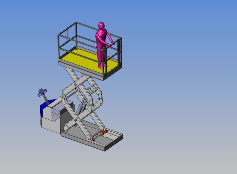

    This is what I've been busting my butt designing this week.--Nahh---It isn't a hovercraft!!! I just haven't got to the wheels yet. Better this week than last week. Last week it was curved windshield assembly fixtures, which involved far too many compound angles.---It gets really nutso when you design something that is so complex that there is no way to draw it---the math data goes directly to the CNC Gods for fabrication. At least on something like this the angles are generally in only one plane.

    A walk behind hand truck manlift cherry picker thing. A Pallet Jack on Steroids. Very cool.
      What type of bearings are you using for the scisor joints?
        Short and simple. Why?
          Very Brave to say the least
          Not that your design is not pure genius - because it is, but the liability to put a product like that to market is staggering.
          Once I stupidly asked the rental agent what was the replacement cost of a 120' Boom Lift. I was completely floored when he told me $645,000.00
          My initial thought was "I must be in the wrong business" but then he told me a hefty portion of that cost reflects all the testing and liability
            One has to ask, "Why wouldn't you just buy a scissor-lift????"
              Where are the sheep leg restraints? And Brian, I don't need it to go so high. Waist height would be good enough for me. And really, you need to get a model of a sheep!
                Using DU style bushings. They have a steel outer shell with a sintered bronze inner liner coated with PTFE
                  Customer wanted the portability of a motorized truck frame, as shown.
                          DU bearings from GGB?
                          I used to work for them, though I wasn't involved with the metal-backed bearings.
                          Have you looked at their Filament Wound Gar-Max (GM-xxxx)bearings? They have slightly lower PV ratings, but can handle tremendous loads and have a very thick liner layer and are very resistant to contamination. We used to sell a ton of them to several scisor lift manufacturers for exactly your application.
                          They had tremendous life spans - infact it was one of the lift makers that prompted us (err, them)to develop the low cost MLG line - not so much for the initial cost benefits, rather for the parts sales after the fact (the MLG bearings have a much thinner teflon layer and no graphite impregnantion so they wear much faster but have the same compressive wall strength.
                          You're not worried about parts sales, so the GarMax or even HSG (High Strength GarMax) would would be something to look into.
