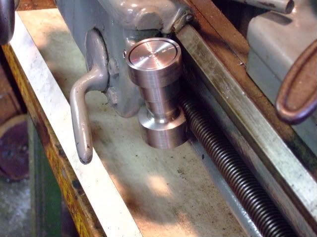

    I hope I can paste these picture in here. I made this thread dial instead of buying one for $100. It took about $10 worth of steel and a couple of rainy days in my workshop. I cut the gear straight not at an angle and did not hob it but file the tops of the teeth to engage the leadscrew easier. Plans from a 1941 Popular Science article showing how to make fixture to cut gear made the difference. The housing was about .125 too long and I had to shave it off with my new HF miller. It works like a boughten one. And it wasn't hard to do. Next I will make a Steadyrest instead of paying the bandits $150. Thank you , Boot <a href="http://s750.photobucket.com/albums/xx142/Boot-010/?action=view&current=DSCF0857.jpg" target="_blank"><img src="http://i750.photobucket.com/albums/xx142/Boot-010/DSCF0857.jpg" border="0" alt="Photobucket"></a>

          Is the info for thePopular Science fixture online, or did you have the article?

              I got the plans from the Pop Sci Archives online. They were in the November 1941 magazine article. I modified somethings to make it easier. I made the dial from two pieces instead of cutting a 1 5/8 cr shaft down to 1/2". Made the outside housing the length required which was about 1/8" too long . Overall length for my lathe was given as 3" It should have maybe been about 2 7/8". Someone over on the Practical Machinist site pointed me to the plans. Gary Hansen I believe. I would also have made the gear from brass or al if I had it. Of course the steel gear will hold up longer if I let it engaged all the time. I won't for fear of wear on leadscrew.
