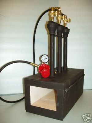

    Long ago I took metal shop in the 9th grade. First project was to make a chisel. The furnace that we used for forging and heat treating was a natural gas fired and was about one cu-ft in size. There were 3 burners on 2 opposite sides facing one another. Here is a comercially avaliable 3 burner Propane forge.
    Anybody know why the burners are vertical?

    Just a guess but maybe the heat would shoot down, rise and you could use it twice.

        My wild guess is that having the burners vertical keeps the forge balanced...not likely to tip over onto the side as it would be if the weight of the burners was off to one side. Another plus is that you're less likely to set your beer down on top of the forge and ruin it.
        The beer, that is.
          Probably just to save bench space.
            I would have to say to save space. And to heat a flat bar more evenly ( bigger target). The flat bar will more than likely be laying flat so the flame will hit the broad side and not the narrow side. But since heat rises and that includes spent air ( no oxygen). The burners might suck up the spent air and not want to burn efficiently. Cold air from the side would be much better.
              I agree that the burners are vertical to save spave. I would not have this forge for the work I do personally. There is going to be a hot spot right under the burners. Burners should not point directly onto the work but should come in to create a vortex or swirling fire. Just my humble opinion but I use a forge about five days a week and have made all my own.

                    most relatively cheap commercial forges use vertical burners, cause its cheap and easy to build em that way.

                    Chile make some nice little forges that use a round shape, with an offset burner, to induce a swirling pattern of heat.

                    I make my own forges, using castable refractory from Pryor Giggey- much better than bricks from Tractor Supply.
                    http://www.pryorgiggey.com/
                    I cast cylinders, using two pieces of sonotube for a mold.
                    Its a design a friend of mine worked out, you can make em any size or shape that way.
                    Castable refractory will last a long long time- and its the radiant heat from the heated up refractory, as much as if not more than, the direct heat from the flame, that makes a forge work.
