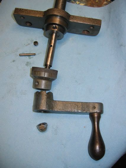

    Bought a Benchmaster horizontal today at an estate sale, for an asking price that was low enough that even my wife said "buy it". Dunno just why, I have a mill, and if I was adding, I'd want a vertical...... but maybe I can swap with someone who wants the horizontal spindle... or sell this when I clean it up. Jury is out, but the mill not having back-gears is pushing towards the 'sell it quick" area, if I don't find a vertical head.
    Anyway...
    The thing I have in pieces, being cleaned of years of crud, and a little rust on some bits. I had to disassemble to get it out of the shop it was in.
    Aside from a lot of dirt, the way surfaces appear to be barely worn, I don't think they were scraped much if at all, they still have some machining marks, but too much material left for that to have been a later re-machine job.
    I WANT to pull out the leadscrews, but they don't want me to do it. They are full of dirt and crud, and I want to clean the bearings out.
    I would also like to adjust them, as they have about 40+ thou of slop, just about ALL of it in the collar adjustment.... the screws and nuts are GOOD.
    The collars appear to be intended to unscrew, although there is barely a quarter thread visible, if that. Just the hint of a thread on the shaft. They each have a setscrew, those are out. The setscrew in each case was squashing a brass plug against the threads that should allow adjusting the nut, or removing it.
    Can anyone confirm the "unscrew" theory?
    I think the brass is squashed and extruded into the threads and maybe the space between collar and shaft.....
    How the &^%$! does one get a brass plug out from inside the threaded hole in a steel collar, when none of the parts have much you can grab without damage?
    So, here is the table one, exploded as far as it will come apart......
    Close up of collar. You can see plug, with setscrew in background.
    Crossfeed screw collar and end.
    Closeup of crossfeed collar, you can see the &^%* plug on this one also. And a decent view of the swarf and dirt in it.
    They didn't waste money on these.... the dials are zamak, held on the screw with a taper pin that does double duty as the handle clutch. Everything else is taper pins also.... and not so easy to tell which is the big and which the small..... I have inadvertently been a "big-endian" a couple times.
    I do like the table locks, they work fine. I intend to copy them for the other mill.

    I suspect those collars are just pushed on. I can't see evidence of threads, just rust. But just to be sure, why not clamp the leadscrew in a vice sandwiched between blocks of some softwood, then attempt to unscrew the collars. At the least you will be able to get them loose, then if they are threaded you know what the adjustment method is. Once they are apart you can decide if you want to add thrust bearings of some sort.
    To avoid marking up the outer surface with the vice grips, put a strip of aluminum around the collar first, then clamp down over that.
      No rust, just dirt, old oil, maybe trick of the light, even though I used flash. Rust in other places, NOT on the screws.
      As for the thread, maybe I get a better picture and you will see the tail off of the thread.....
      Why not put in a vise? Well because in one case, the screw is down inside a casting where there is no room for a vise. I already tried a gear puller, no go.
      But, no sense working as if there is a screw if in fact no screw is there... hence asking Benchmaster owners if they can confirm it.
      Also very little reason to have the brass plug if no screw threads......
      here is a picture that shows the thread end..... sorry for bad focus, this camera gives little choice, I tried to get it to focus on the scriber, but no luck.

                A slightly longer set screw or small stud would let you get some purchase on the outside with a hook spanner or equivalent. Back off the screw just enough that you know the brass has room to back out a little
                  Ha... I don't need ANY better purchase on the OUTSIDE, what I need is to grab the acme thread better...... at least for the moment.
                  I would suggest in future using aluminum plug. Yes it may distort etc, but you can always dunk it in lye.......
                  1601
                    Something similar to a pin spanner- just a hole the size of the collar in a piece of bar. Drill a second hole thru the side into the larger hole, and use a bolt with the same threads as the setscrew to act as the pin. Maybe cut off the threads on the bolt leaving just enough to thread into the collar. The tool will then be pushing on the shank part of the bolt and should keep it from tilting sideways.
                    If you can't clamp on the leadscrew threads, then clamp on the handle side, again using some wood blocks as protection. As those collars are threaded on, the brass plug should be just resting on top of the threads. You wouldn't screw the pin bolt in far enough to compress the plug against the threads, so it should just float loose once the collar starts moving.

                          Lacking any input, the problem resolved itself with PBlaster, time, and a decision to sieze the two parts with pump pliers and give them a mighty twist.
                          Both screw assemblies unscrewed.
                          So the one remaining problem is a pin that will not drive out. It has been solved by a policy of masterly neglect, cleaning the rest of teh knee assembly, and NOT cleaning the knee crank shaft.
                          The collar still in place in pic is probably also screwed on, but I have no reason to remove it.
                          In the pic, of the crossfeed, the little brass piece is the slug. it is much bigger in diameter than it is wide. And,, it did not seen to be bearing on the threads in any significant way, not even a small indent on either side.
