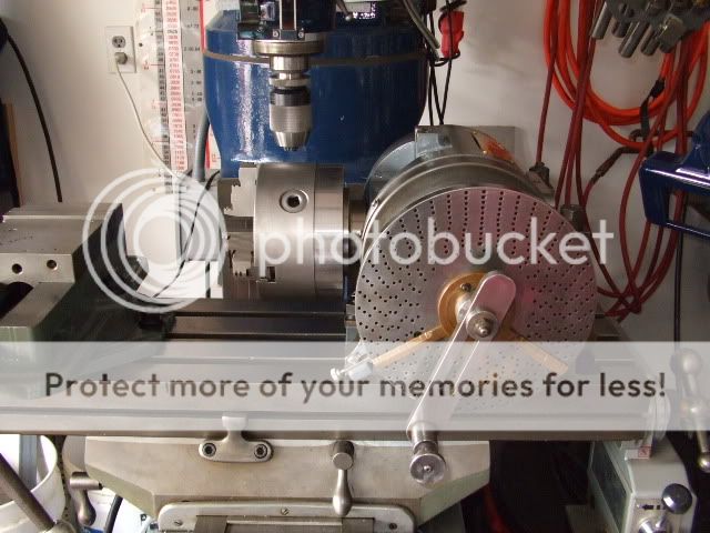

    Has anyone ever tried bolting some sort of a lift to the side of their mill?
    My Cincinnati dividing head is way to heavy for one man to move around.
    Thanks

    I would think the weight of the lift (used to lift the dividing head) would throw off the tram of the table. I've seen photos of different ways of doing this, but they were either on a tram attached to the ceiling, or a mobile lift that would roll around the floor.

      I was thinking of something I could fab up that would bolt to the lower mill base side and that would swing backwards to remove the dividing head from the table.
        Jib
        I fabricated a jib crane for my mill for the same reason. The arm is a section of 'uni-strut' and I installed a chain hoist . The boom is about 6 ft long and easily handles my weight, 250lb, without any problems. See the attached link for more details. I have a fixed rail with a block for lifting the chucks for my lathe.

              That is a big dividing head. Many of them have a tapped hole for an eye-bolt for lifting.
              I have the same trouble with my "Vertex" 8" which weighs 70Kg ~ 155 # if all together.

              I have no problem lifting my dividing head onto my HF-45 mill table as I just put it on wooden rails and slide it across. My dividing head lives on a shelf under one of my benches. It just slides onto and off the trolley and the shelf. The trolley can move to and be used at any accessible point in the shop.

                              You don't need a lift if you can set up a swing for it.
                              I have a swing to take my vertical head (which I can manage alone if I brace myself for it) from the mill to a bracket bolted to the side of some steel shelving, while I use the mill for horizontal work. I use two 3/16 wire rope loops around a rod through two ceiling joists to anchor the swing. Witrh the shelf and the right height, it all works fine. I leave my ropes permanently attached, and I suppose they bother me less than if they were dangling around the top of a dividing head.
                              You'd have to use a hook, but with a spare rope to pull the head over so it's hovering over the table, wind the table up to meet the head, bolts in, detach the hook, and Bob's your uncle.
