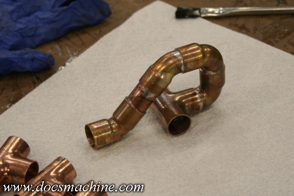

                            Here's a sample of my long-term shop-air project. These are the drops off the "halo"- well, the original plan was to have a full circle, but that may not be feasible thanks to the shape of the shop and preexisiting fixturing.
                            I "mass produced" a dozen or so of these elbows out of 1/2" fittings so the actual installation involved a minimum of soldering while up on a ladder or near a wall.
                            The "loop" taps the air off the line from the top, so any collected moisture continues down the line's slope to the main water trap/drop. I forget where I got the idea, probably off of Garagejournal a few years ago, but it appears to work nicely so far.
                            As for the iron/copper thing, I used to have black iron in a fairly simple setup with a surge tank and a handful of drops, but everything leaked. Even with pipe dope or teflon tape (and yes, I know how to properly apply it) virtually every connection had some minor seepage.
                            No big deal individually, but collectively, the compressor would run two or three times a day (and likely again at night) even if I wasn't using any air.
                            I can solder far better than I can thread, and modifying involves nothing more than a tubing cutter and a torch, rather than two pipe wrenches, a threader, and taking apart half the downstream fittings.
                            Doc.
