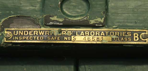

        Your fire-safe class B rating is a SMNA rating that is obsolete
        (not to be confused with current UL class B rating).
        Relevent information on this rating is located here:
        Estimated weight: 1,000 - 2,000 lbs (quite light, due to rock wool).
        This safe will give some fire protection, and limited burglary protection.
        It is designed to protect documents, e.g. paper (not wood).
        In a fire, the moisture in the rock wool turns to steam & transfers to the paper, & keeps the temp below 451 deg far.
        This safe is not designed to protect wood from fire.... I guess there would be damage from the steam/moisture.
        It's size however, will impress and reassure the customer, & I'm sure they don't want to know all these details.

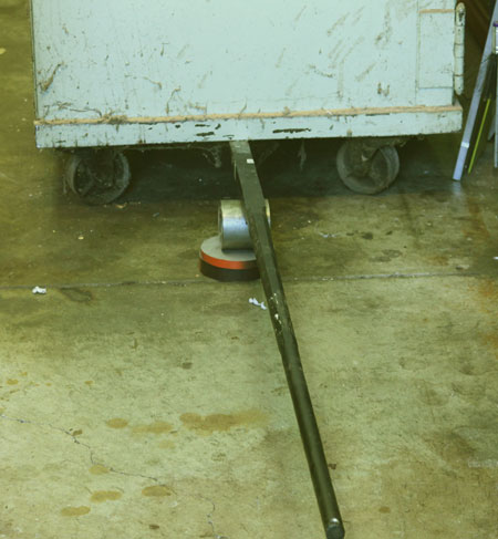

          Thanks for the thoughts, everyone. Hope I didn't waste anybody's time here - as I was finally digging the safe out from the back corner of my shop, I realized I could easily estimate its weight.
          So, I took one of my long pry bars and adjusted a fulcrum until by standing on the very end I could just lift two wheels off the ground. Then, by simple length measurement and math, I came out with a weight very close to 1800 lbs.
          It's been so long since I doped on that green paint, I'd forgotten exactly what was written on the tag, so I used a bit of paint remover to reveal that it is:

            I did the same thing about 50 years ago when I was asked to get the weight of a safe only I used a 2" x 6" board and a piece of pipe. The safe was later run over a scale and I was only off by about 50 pounds.

              What is the formula when you are only lifting one end? I want to know what my mill weighs, and this technique should work great.
              153 pounds at the end of 5 foot on left side of fulcrum and 1 foot of lever to the mill = how many pounds? Does something have to be divided by two because the other end is still on the ground?

                      So, that would be the outboard section of the bar from the fulcrum divided by the lifting portion from the fulcum, multiplied by your weight or (5/1) x 153 = 765 to lift that end. In the case of a symmetrical hunk of junk like my safe, then the total would be twice that amount.
                      If you're lifting something like a lathe, you'd have to do both ends separately and add them because the weight is so clearly not centered. Not sure about the mill - 'spect it would be easy enough to do the operation twice. . .

                        Thank you Fred.
                        It's easy to find all sorts of formulas for fulcrums, but they always seem to concentrate on the amounyt of force applied, and never on how to use that force. I should have paid more attention in high school. If I'd only known....

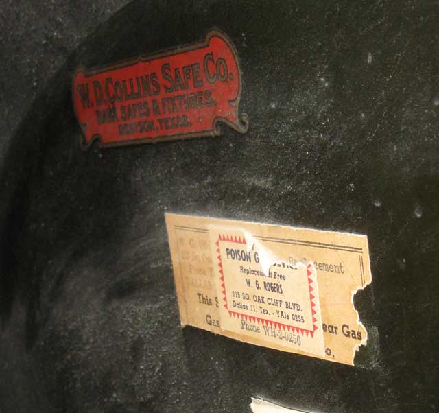

                          Don't know about the old dynamite, but one of my board regulars is currently restoring/refurbishing an old storefront building in Texas. The building came with an old safe (open, empty) that has this sticker inside:
                          Supposedly the door contained (or may still contain?) a glass vial filled with "poison gas", that would shatter and release the gas if anyone tried to break in.
                          Anyone have any guesses as to what kind of "gas" it might have contained? The underlying sticker suggests "tear" gas rather than "poison", so maybe just an ammonia-based irritant? Like strong smelling salts?

                            Those old phone numbers bring back memories. Our first phone number in about 1945 was YAle-8306. That was 6 digits and no area code. I lived not far from the address on that old sticker. The YAle exchange changed to WHitehall then later the extry number 2 was added making it WH 2 8306 then finally the area codes came in.

                              Or Mustard Gas .
