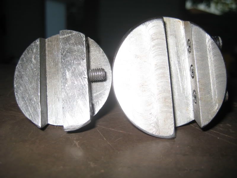

    Left is store-bought. Right is shop-made. Can you tell the subtle difference?
    Looks like one is for CW rotation and the other is for CCW. But both came with bits for CCW rotation.
    The store bought one pushes the cutting tool away from the centerline. It also required two operations even before the holes were drilled. Either tool will work CW or CCW with the correct cutter.
      I thought the cutting part of the bit should always be on the centerline?
        You're correct about the cutter being on center.
        The other difference is that the store bought one is balanced.
          I think by the time the cutter is in the slot neither is particularly balanced. Empty, the store-bought one looks better balanced, but they don't run empty.
          Both have a logical default operating direction when used conventionally with the store-bought version turning CW. The shop made one may have been built to turn CCW as one of those little lapses of concentration . I'd still toss out the store-bought version and get one that has the cutter seated against the centerline.
            Throwing it out
            The "store-bought" item is much better balanced and will reduce "throw" due to eccentricity of the centre of mass/gravity:
            It has two reductions:
            - the step where the screw heads/adjustments are; and
            - the large "scoop-out" (part of a circle ie an arc) at the front.

              Shouldn't the setscrews push the toolbit against the shoulder with the cutting forces, instead of against the cutting force?
                        Yes you got it, and its something I immediately seen also, the store bought one is the only one that's properly designed...
                        The "home brew" applies its cutting forces against the set screws and this is a big no-no as set screws work by extremely high unit pressures so if the machining forces/chatter/frequencies are applied against them they will either set into the bit material more or deform their ends - either way tension is lost and one will be wearing the tool bit to the hospital by the end of the day.
                        The home brew guy was a hillbilly and should not be designing tooling,
                        the verification is that we do not cut by the trailing edge of the tool bit, its the leading edge - so there is no way you can line the leading edge of the tool bit up in the configuration that he has cw or ccw(and remain on center) unless you load the set screws directly against the cutting forces...

                              In reality neither fly cutter is properly constructed.
                              1) the slot should be made so that the top of the cutting tool is on center.
                              2) the set screws should apply force to hold the cutting tool to the side of the slot that is on center.
                              3) even though the length of the cutting tool and its placement will vary, effort should be made to balance the fly cutter.
