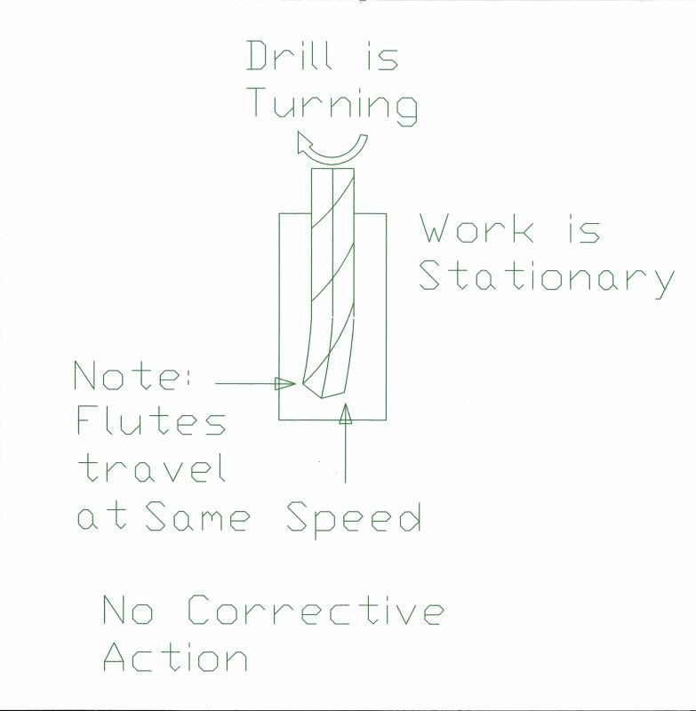

    PART 1
    Here is a sketch of a hole being drilled in a drill press or Mill
    Now I have exaggerated the bend but please "know" the concept.
    I was taught this years ago by a expert in gundrilling. Any drill will deflect.
    Causes are incorrect sharpening, poor starting location/error, spindle/ chuck issues, or hard spots/inclusions in the material.
    The thing to realise is that on a drill, the tips or outer edges of the bit see the most load. They cut the most material...obviously
    When the drill is rotating however, the tips both travel at the same speed ( say 1000 inches per minute) as they revolve around the centerline of the drill.
    This means if the drill drifts, it does not know it and continues of its merry way...in total error. Note the centerline of Rotation always coincides with the flute tips ! This drill will follow the line of least resistance
    PART 2
    Now lets look at rotating the work piece and keeping the drill stationary.
    You normally see this in a Lathe setup. We will use the same drill here.
    The physics is now different. The center of rotation ( COR) never changes !
    This causes the drill bit tips to try to stay balanced
    Neither one wants to do more work than the other.
    Note as the distance increases from the COR the loads get greater
    As you go outward the distance for the tip to travel increases, so the 1000 IPM may go to 1001, and the other tip drops to 999. This causes the drill bit to self correct, as the drill will bend back literally to keep the loads equal.
    ( By the way, this is why some poorly sharpened drills still cut OK, even though the angles are not equal, the cutting loads are balanced, so the drill is happy .. do not do this however )

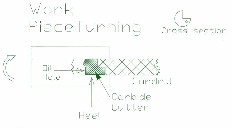

    Part 3
    Now we look at Gundrilling.
    The thin sheet metal drill, becomes hard as a rock when the oil flows through it, because the discharge hole is smaller (restrictive)
    The drill bit is retracted to show what the hole looks like .
    It is quite different from a normally seen hole
    The gundrill has a single cutting edge (flute ) with two seperate angles seen here. I have flattened out the drill so you can see it easier.
    Like the lathe in #2, Gundrillers generally rotate the work piece for accuracy.
    The two angles on the carbide fight each other, with the outer tip trying to win, by forcing itself inward, however all that force is repelled by the Heel or wearpad of the carbide on the opposite side. The pad is riding on the fresh smooth surface of the hole. This is similar to a car with lots of toe-in on the front wheels . the angles are critical because the inner angle takes as much load off the outer tip as possible, and yet keep the tip from twisting off and going straight.
    Remember the discussion on centerdrilling the start hole ?
    Now you can see why a prepped hole made with a Ball endmill is so important.
    The hole is to size, and guiding the drill flutes, which will always give better accuracy for deep drilling as it is a larger surface than a small hole!!

            Thank You for your questions Beanbag
            First, I didn't address a severe off center hole start so your example can be discussed but it is impossible to replicate in the real world. No drill would allow such an error before breaking. Poorly placed starting holes prevent any accuracy for hole location and I really don't want to go there as you have maybe 10 MORE variables, but here is your question :
            ...". In the case where the hole is off-center, and the workpiece rotates, there is NO change in the sfm from one part of the hole to another.".....
            I disagree Beanbag , and tried to show that in photo #2
            The portion of the hole furthest from the C/L of rotation inscribes a larger circle ,or circumference relative to the C/L and thus has a faster speed.
            The reason I was showing speed was to show that it had more material to remove (per revolution), compared to the inner flute. The more material, the more relative load ( look at a light boring bar, taking a heavy cut, compared to a light cut)
            We know that drill bits dislike unbalanced loads
            When you enlarge a hole, you cannot make the drill go to one side, because the drill always wants to see a balanced load on the flutes, thus it follows the pre-drilled hole.( By the way, we are only talking about 2 flute cutters)
            I have to admit, I don't understand what the springiness or inertia of the drill has to do with maintaining accuracy. I would say they are detrements.
            Look at an aircraft drill which is solid, or a Gun drill which is as near a solid as possible. A drill not spinning has no inertia, other than static inertia, in which case, if the load presented to the flute is less than the yield point of the drill design and material, the drill will cut it. If the load is greater , the drill deflects
            I was hoping this would help understand the physics of deep hole drilling.
            While we did gundrilling at work, our gundrilling vendor in Paramont CA would quote us with this accuracy ratio.
            Round work drilled had .0001 per inch runout (think lathe)
            Large stationary work .0015 per inch runout ( think Mill)
            Others can be better or worse
