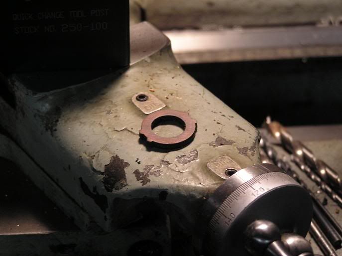

    Had to make a phenolic wahser with ears but no rotary table available. Cut a blank oversize with hole, tunr to major od and thicknes (that stuff really stinks when you machine it), put in drill spindle on lathe, used the crossfeed to set depth, mill to marks on the chuck rotating chuck by hand. Not terribly accurate but solved the problem. Filed ears to final shape. If I were to do again I'd put a collar behind the bushing to keep the cutter from sucking in.

    OK, why cant I get my 2nd of 3 pics to show?
      They're showing now.
        I like your 'milling spindle' more then the rotary table idea
        Hope you let that chuck rust on real good to prevent it comming off if your gonna mill with it.. :P
        (Little bit of acid or even skin moisture/sweat on a JT taper is by far the best and most common (accidental) way of insuring a JT chuck will never come off, short of destorying the chuck.) Well, that or drill and tap a screw to secure it.
          Thanks Moons but no worries. Just put the chuck on there for this use and its already off( its a threaded chuck BTW on a straight shaft). Only using an 1/8" cutter and taking off about 1/16 DOC so the cutting forces were very small.
          I have a milling machine but no RT. Now upon reflection though I could have used a rotary indexer with a little more set up time.
            Clever solution.
            You could have done it in the mill also. The fact that you only needed 180 degree indexing is the key. Mount it vertically in the vise and center it under the spindle. Cut one side and raise the spindle. Go to the other side and cut it in the opposite direction.

                  I have no reservations about using a Jacobs chuck in that situation - at all.
                  I would have supported the fibre disk with brass (optional steel) washers so that the helix on the cutter did not "pull" the fibre disk.
                  As the OP said he didn't have a rotary table, I presume that inasmuch as he didn't say that he didn't have a mill that he has a vertical mill.
                  In that situation, I'd have used my "Spindexer" clamped vertically to an angle plate. My Spindexer has a C5>ER-32 collet adaptor, so i could hold any shaft between 2.0mm (~0.080") and 20mm (~0.800").
                  The index marks on the Spindexer are good enough to "eye-in" the required angular settings to about +/- 1 degree.
                  Just use the collet fastening handle to rotate the Spindexer spindle and the job.
