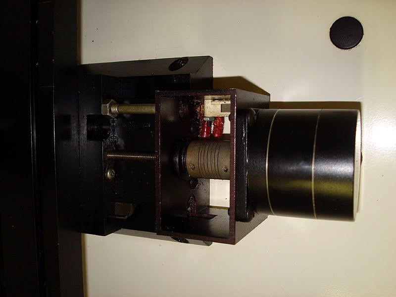

      Picture on one that i made for a stepper motor to indexer.
        Thanks yet again Evan. It's definitely 1/4" shaft size and yes a couple sleeves will be no problem. There are some overall size limitations though. Can you slap a caliper across the O.D. and length please? I'll check when I get back home from work tonight and see if it'll fit.
        Gary I've saved your post and pics in my CNC stuff folder. That's a great solution! Not quite as painless as Evan's though.
        ps: Evan you're plum dangerous with Paint Sho Pro!
          It is 1.123" x 1.123" Nominal 1 1/8"

                      Yes, the sherline couplers are rather unusual. They put a cone/taper on the end of the lead screw.
                      These general types of couplers are off the shelf items that you can find at the usual industrial parts distributors or by doing a froogle search on "helical shaft coupler". They can be had for around $20.

                      Long ago, I made a rigid version out of brass for the Z axis on my sherline:
                      At the time, I was using old beefy steppers that had really good bearings and using the motor bearings provided zero backlash; most modern steppers can't handle this. Note that the flat for the screws is weak and a stress fracture did develop on the inside corner from the force required to clamp the coupling - a counterbore is better. But if you have flats on your shafts, a set screw into the flat is better. The clamp type require some rather severe forces to bend the metal.
                      The flexible couplings are made the same way but with more slits.
                      An alternative to the spiral cut is a series of cuts on opposite sides almost half the way through with a slitting saw, rotating the coupler 90 degrees between pairs of slits. You need at least 4 pairs of slits. Leave a gap in the middle between the first two and last two slits to allow greater flex. You don't see these as much now; I think once you are set up, the helical ones can be cranked out a little faster because once the cut is started you are removing a consistent amount of metal. You should be able to make this on the mill with a slitting saw even with one axis out of commission.
