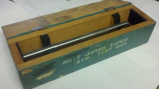

    I picked up a 12 inch test bar in a lot of tools I purchased. On the box it says No 7 Jarno Taper. I did some research and found that the Jarno taper stems from Oscar J Beale at B&S that came up with it and has a taper of 0.050" per inch or .600" per foot. My question is to find out what machines have a Jarno taper?

        The Monarch 10EE's have a #12 JARNO taper.
        Hal
          10EEs have a Jarno 12. Tool grinders have Jarno. All jarno tapers have the same pitch, not variable like morse. The number signifies in 1/8ths the major gauge diameter.
            American lathes have it in the head stock. Some grinders use it too. Jarno taper centers are NOT cheap!

                      A tool like this could be used to set the head stock/tailstock alignment as it has a .050 per inch taper. There are other tools, but it has a use.
