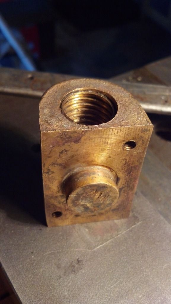

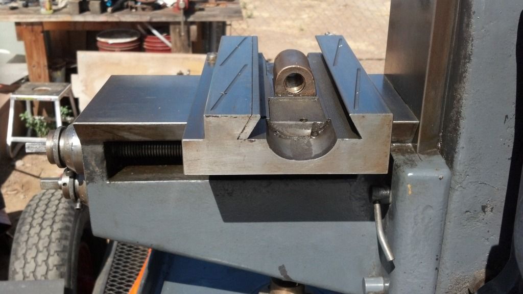

                              I am looking for suggestions for the repair of my Y axis lead screw nut. I want to do the acetal repair but I'm not sure what the best method would be in regards to the design of my nut. I'm posting some pictures hoping that some of the wizards on here give me a flake of wisdom. I have access to a worn out old Bridgeport and a 9 x 20 HF lathe.
                              I was thinking about milling out this nut to accept a square of Acetal, but now I am wondering if starting from scratch with a raw block would yield better results. Also, I don't have much headroom unless I mill out the bottom of my table, so that is out of the question.

                              • Ok.... I haven't done this yet, but I've given it some thought, as I have a sloppy feed nut to replace...
                                I was thinking I'd make up a pair of half-pipe sections in steel as a "press" to fit around the acetal, a little larger ID than the finished nut insert OD, turn the acetal blank to fit then bore to slightly smaller ID than the screw pitch diameter, and split longitudinally so it can be clamped around.the screw. Once all assembled, put in the vice or a press and heat the screw until the acetal flows and fuses. Once cooled, peel off the half-pipes (might be worth using a release agent, silicone?) and true the nut insert in the lathe, centring off the screw, finally bore the remains of the original nut and bond in the acetal insert.
                                Dunno whether it would work, but planning to give it a go!
