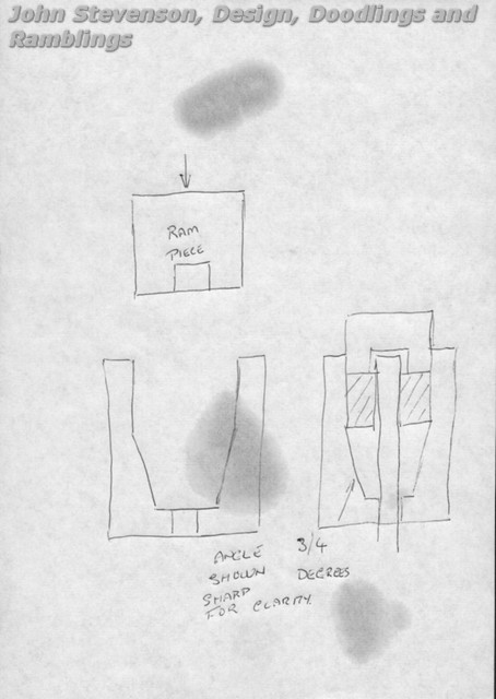

                        • I have made quite a few Delrin nuts with a variation of the theme.
                          My method is slightly different in that the two previous methods you had to split the nut and force it round the screw.
                          I made mine with the bore of the nut the same as the OD but tight, in other words a pre-stripped nut. Cut the middle man out.
                          I think this sketch explains it better.
                          Basically you thread the 'new' nut over the screw, drop unto a tapered cup and fit a ram piece. This then goes onto a press and the cup and screw is heated with a hot air gun whilst pressure is applied.
                          This has the advantage of making it one piece and with a bit of experiment on how far you press the cup in you can choose what fit you want. Something the squeeze in the vise method can't do.
                          AFAIK this method is my own and I have not seen it repeated anywhere else.
                          Because at one time I had loads of ball screw thread offcuts from cutting long screws down i even made some Delrin nuts to fit these screws. Not as good as ball screws by any means but certainly better than Acme screws.
                          Again nothing new here Moore International make screws and nuts such as these and call them Ronda screws.
                          Any Google Child can find them.
                          [EDIT] There should be no gap between the ram piece and the top of the screw so as the ram piece is pressed down it carries the nut and screw with it so it cannot push the threads.

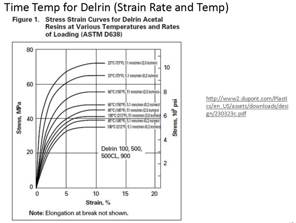

                            • Re: the Stevonut method -- instead of using a heat gun, how about putting the delrin blank, the tapered cup, and the ram piece (and the screw, too, if it will fit) in a pot of boiling water. Then, quick like a bunny, put the lot on the press and have at it. The yield pressure/temperature curve for delrin (see below) shows that at 100 degrees C, it only requires about 6,000 psi to make delrin flow. In fact, the curves suggest that at 10,000 psi, the operation can be done at room temperature. That's easily achievable with a garden-variety hydraulic press. Evan, what sayest thou?
                              Another thought: Is the taper in the cup really necessary? Once the plastic starts flowing, does the shape of the mold make a difference?
                              • The boiling point of water isn't quite hot enough. That is still below the glass transition temp. It must be at least 120C and preferably a bit higher. Below that temp the molecules are being sheared apart and that weakens the entire matrix. Above that temp the molecules are free to move without damage. Both Delrin and acetal are crystalline polymers although they don't look anything like a crystal.
