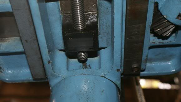

                    Hi

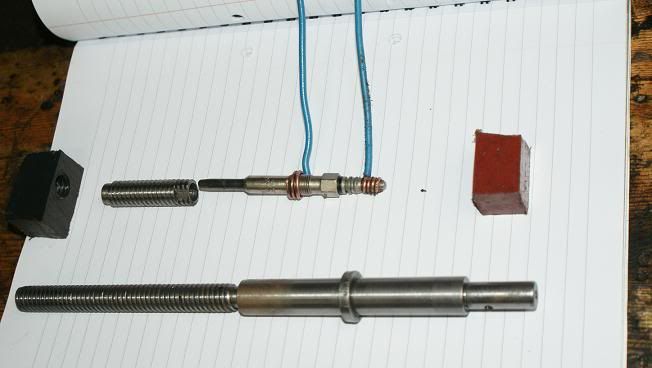

                    Thanks to Evan I finally got around to making a lead screw and nut for an ageing Union T & C Grinder and thought I should share the method used.
                    Cut the lead screw with ACME half inch by 10 RH thread from FCMS but with an additional 2 inches length on the thread which was parted off and drilled to take a heater glow plug to make a “Hot Tap”. A nose of hole dia. is formed on the hot tap. Glow plugs are used to aid starting of diesel engines.
                    Two flats were milled on the hot tap to take a small spanner which is held by hand and used to “feel” how soft the synthetic material is as hot tap is being screwed in.
                    The set up on a lathe is: 4 jaw chuck, nut drilled to lead screw dia. less one thread thickness, "hot tap" with glow plug inserted and connected to a basic 12Volt battery charger, push piece with hole mounted on lathe tool post and on lathe centreline.
                    Procedure is: Setup 10 TPI on lathe and very slow spindle speed, switch on Battery charger and wait (seconds) until "hot tap" is hot, engage thread lead screw on lathe and insert "hot tap in prepared hole(approx 10 turns in my case), switch off battery charger and allow to cool.
                    There is no attempt at precision before or during the nut thread forming process. Precision is achieved after a satisfactory nut is threaded by inserting the lead screw and aligning screw/nut combination on lathe or mill and machining as necessary.
                    I did plenty of practice runs on scrap pieces on synthetic materials (don't know what they are because origin is scrap yards). With practice, this procedure takes less than 30 seconds any longer and the hot tap overheats. I believe the final nut selected to be toughnol.
                    Battery charger shows 4 amps with this glow plug. Plug goes red literally in seconds. This is much too hot for synthetic material but with hot tap outer sheath and limited time some temperature control can be affected.
                    Others have mentioned that nuts are tight and this was my experience. I used a hand held drill to “run in” the practice and final nut.
                    Failures were due in one case to overheating the hot tap and in one case to overheating during the “running in” process.
                    I intend to make a cross feed lead screw and nut for my lathe will use this method. May use a slice of the nut material set on the hot tap to give an indication (it melts) of when to insert the hot tap.
                    Photos are attached and questions welcome. Trust this explanation is sufficient.
                    The T&C Grinder is now a delight to use.
                    Cheers
                    Paul

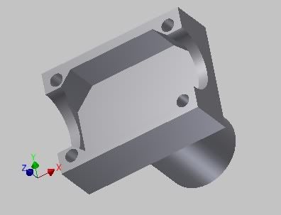

                          • Firstly, many thanks to Evan and crew for developing and documenting this slick way to make acetal nuts. I'm doing a CNC retrofit on a Clausing 5914 lathe and this looks like a great way to make zero lash nuts for it.
                            I'm working on the cross-slide nut first and room for it is tight so I'm going to try a slightly different approach where I machine a split housing that will be filled with acetal "blanks" with the whole assembly molded around the nut.

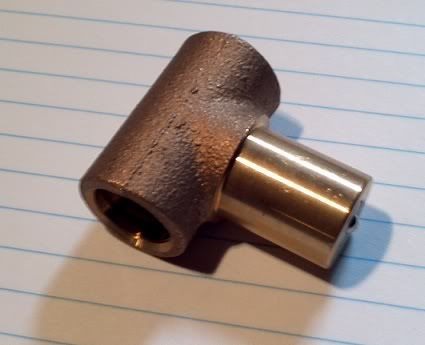

                            Here's what the stock nut looks like:
                            It mounts by a set screw that clamps the round stud. Its a flexible design as it can rotate to set the x-y plane right and also be moved up or down get its Z plane setting right. This flexibility in the mounting method should make it easier to get the acetal version aligned.
                            Here's the top half of the housing, I'm planning to machine it out of brass. There will be a bottom shell that is the same as this part minus the mounting stud. Four 6-32 screws in the corners clamp the two shells together.
                            I plan to fill the halves with 2 acetal blanks, with the correctly undersized clearance half-round grooves machined in to them, then use the 6-32 screws to clamp the halves together as the screw is heated.
                            Does anyone see any problems with this or have any tips on making it work out?
