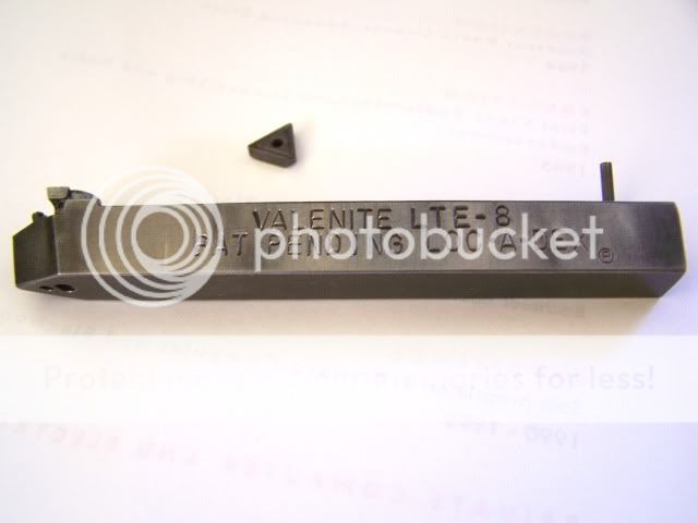

    In a frustrated moment last night, I began digging through some archives and came across this insert holder. I was fully confident that Google would yield all the info on this holder I would need, but alas.....NADA. I understand from some posts that perhaps Valenite was bought out by Kennametal, who may have killed off a bunch of Valenite's product lines, etc.
    In any event, I'm a lost pup. I'm an insert newbie on top of that. Any way of determining a current insert number/type? Looks like a pretty good holder, so I'd hate to relegate it back to the "I'll get to that later" pile. It's obviously a threading insert: thickness .125 and mounting hole looks to be .0875. I have a bolt threading project coming up, and I thought I might give an insert a try.

    You'll need to start by figuring the IC or inscribed circle.That is the largest circle that will fit inside the bounds of the insert shape.Usually its something common like 1/4-3/8-1/2 etc.

      I do not think it's a threading tool.
      The insert look like a TNMG-332...
      The holder MTENN negative cutter.
      Great for chamfers.

        Well.....my newbie insert label is still intact. From my continuing research, It thought an MTENN was a threading holder.....maybe not.
        I did find out from Walter, who apparently consumed Valenite, that it takes a TNMG222, recommended M3 for threading. Does that shed any light?
        All that having been said, what does one suggest for threading inserts in low to medium carbon steel? I'm finding this stuff is incredibly proprietary and confusing to say the least. If you get a holder, are you married to that maker's inserts? Big time ignorance being shown here......so easy on me.

            That is not a threading insert are holder . Standerd turning and champfering. insert .
              You have a very old one.

                          While the LTE-8 holder is not intended to be a threading tool holder, but in this instance it can be used IF you get an insert with no more than a .0179" radius on the tips.
                          I've found that holder in my "Turning 2007" Valenite catalog. The insert spec posted is correct, though you could also use a TNMP221, TNMG221 or TNMM221 insert. The TNMG222 has a .031" radius, I think too big for the root of a 1-1/4-7 thread.
                          The only current insert that makes sense is a Walter Valenite TNMM221 ER-PN1 grade VP5615. It looks like this one but this one is the bigger 5/16" I.C. size.
                          http://cgi.ebay.com/8pc-TNMM-2-522ER...item4ce3bb4b41
                          If you get that style, be sure to use the compound infeed as the chip breaker design is not intended for cutting on the "back side".

                            Thanks, Pix. I was using the insert shown in the pic, and I have no idea what it was, but it appeared to have a radius closer to 1/32" rather than 1/64". Your comment about compound infeed is interesting as this particular insert had no reservation about breaking once I was getting close to the final passes. That tendency had me re-thinking the idea of using inserts for deep threading on Grade 5.
