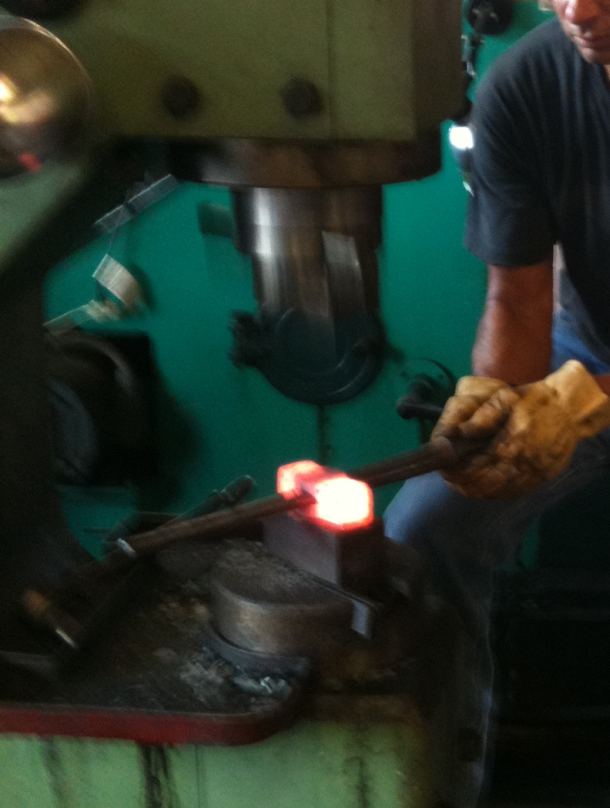

    In the companion thread, Forging a blacksmith's hammer I showed Will Bastas, a well-known blacksmith, using a Sahinler power hammer. These are massive (2600 lb) machines, with a 75 lb ram.
    The dies are large: 4.75" x 2.375" x 3.5", and weigh around 11 lbs each. The dovetailed blocks above and below the hot metal:

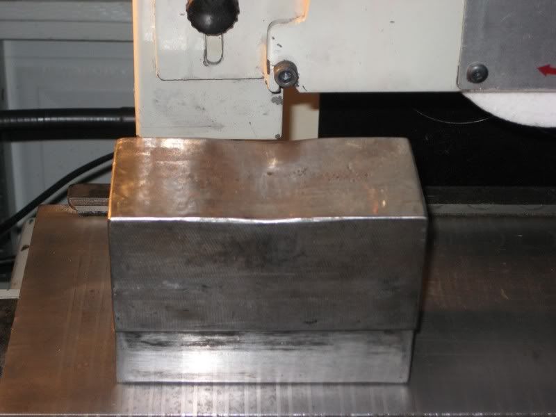

    They're through-hardened S-7, but as you can imagine, they eventually become wallowed from pounding 2500° metal:

      Will gave me a set of the Sahinler die blocks, and asked if I could resurface them. They're $400/set, so I was a bit nervous...
      http://powerhammers.com/pages/hammer...tid=2&mrchid=5
      It's hard to tell from the initial photo, but there's ~ 1/8", highly asymmetric depression in the middle of the die blocks. I measured the surface hardness before I started, and they had a work hardened skin that was well above 60 Rockwell.
      The skin followed the wallow, and was wildly asymmetric: there's a V-shaped trough that starts on one side of the die block and both depens and widens toward the other edge. Along the long axis, there were two humps about an inch in from the ends, with a deep valley in the center.
      I was originally planning to mill the dies with an APKT facemill my Excello and then touch it up with the surface grinder, but I would have gone through at least one set of inserts. 5 APKT inserts @ $7 each...
      So I ended up doing the whole job on my surface Grinder (a Harig 6x18 manual).
      ...and this is what the first pass was looking like:

            After I got past the work-hardened skin (about 2 thou), I measured the core die at 50 Rockwell, which matches the manufacturer's specs (good! ):
            http://powerhammers.com/pages/hammerhead_dies.cgi
            Grinding off this much of the surface generated a tremendous amount of heat, so I did both dies in parallel, swapping them out ever 10 minutes or so to let them cool off.
            This is the second (upper) die. Notice the wallow is different. I had to change the feed almost every pass to account for the different amounts of material I was removing. Much more material removed at one edge than the center, the least amount of material removed at the far edge.

              It's a Harig 6x18 manual. 1 HP motor. Probably would have been faster with coolant, but the machine had no problems.
              How's the wheel wear?
              It was a lot of grinding -- I went through most of an 32A46-I (open, coarse) wheel.
              So after some serious rough grinding to remove the wallow on the upper and lower die blocks, I went over the surface with a single finishing pass with a 60-grit wheel. There's some optical waviness on one edge (with the deepest grind) from the previous rough grinding that I could have removed with another pass or two, but it's a power hammer die -- no point.
              I chamfered the edges on the belt grinder, and here's the final product. I don't know why the picture is showing that hazy border on the bottom corner of the die in the foreground (flash effect?) -- the die is perfectly smooth. Will was really happy with it
