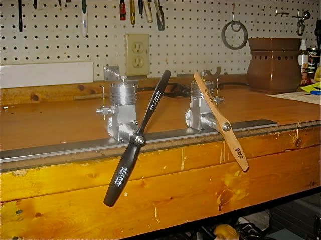

    Went ahead and made two. One was the learning engine, other was the good one. Easier to make two with the set ups are already in place. I think the learning engine maybe close enough to run.
    [IMG][/IMG]

    Neat looking engines. I see the blocks are made from alloy, but what about the cylinders?
    Being engines for model aircraft, do you think there is any scope for weight reduction?

      Pistons are cast iron, and sleeves are steel. They are the Boll aero engines from the plans Chris Boll kindly supplied on the web.

          Do the propellers rotate in different directions so that you don't end up with unbalanced torque when you are flying that workbench around.

            If those are glow plug 2 strokes they aren't really diesels. The only similarity is that they require no spark for ignition.
            If I'm correct and they are like the Cox .049cc we use "Model airplane fuel" in Canada which I understand is a mix of Methanol and castor oil and can be found in any R/C hobby store.
            They look pretty nice.
              In the US, all the model engines are glow plug style that use nitro methane fuel. Thought it would be cool to have one that did not require a battery to start it. I have done a little research now and found out that the amyl nitrate is, or was a inhalant drug (locker room, rush.etc) that you can not buy in the US any more. Stupid me, should of checked into fuel before I started on them.I thought I could find fuel after I made the engines. It's only a 3% component of the fuel. (used as a combustion enhancer) Maybe I could leave it out and use a drill motor to start them? Both of them make a really sweet "pooping" sound when turned over.
                I think you are mistaking the compression adjusters for glow plugs Mike.

                  Those aren't glow engines, they are compression ignition engines.
                  Many pundits will argue ad nauseum that they aren't diesels because they don't have fuel injection but they do start and run well using compression ignition alone. Granted, the fuel is a big part of it but they do not use external batteries to start.

                      If my tenth attempt looked as good as your learning engine, I'd be pretty smug. Nice looking engines.

                          Thank you for the compliment. I wish some machinist guys would drop by and look over my shoulders. Books don't cut it! Those last .001"-.005" always screw me up.
