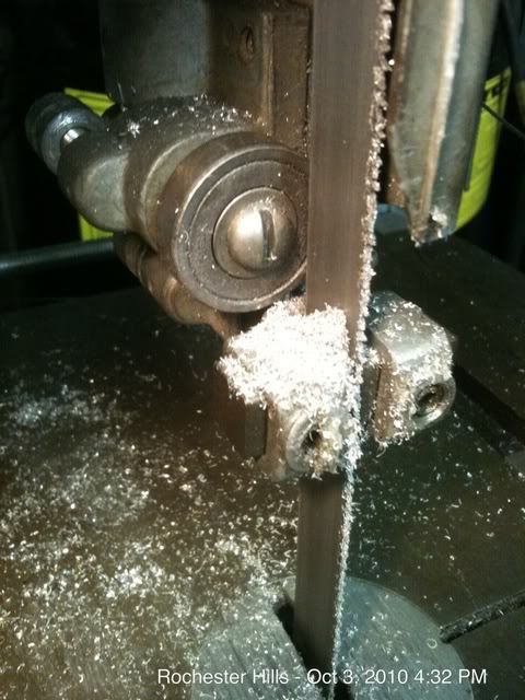

    I've used this bandsaw a lot but I'm curious if I have it setup correctly.
    the instructions say to keep the bearing ~ 1/16" from the blade. if this is true, what is the bearing for?
    Rob
    When you feed the material into the blade it deflects back and the
    bearing then suports from deflecting further.
    ...lew...
      No rubbing the bearing, when work is not pushing. AND keeps folks from adjusting the thing so the blade runs with great force on the bearing.
        so the blade is supposed to make contact with the bearing when I'm cutting? but not when there isn't any force being applied.
        Rob
          That's how I run mine, except I have a hair's width between the blade and bearing when I'm not cutting anything.

                  A common method of setting the clearance on all the blade guides is to use the width of a dollar bill.
                    Are you sure bout that width of a dollar bill thing? Seems that would be about 5" or so..... Just kidding I know u meant thickness.
                    That pin is probably a #4 taper pin, I checked one I have here and the numbers come up pretty close yours.
                    al
                    I spent most of my money on women and booze, the rest I just wasted.
                      I guess you could use a dollar bill if you had one handy. I just eyeball the guides so that they are just free of touching on each side on both upper and lower guide sets.
