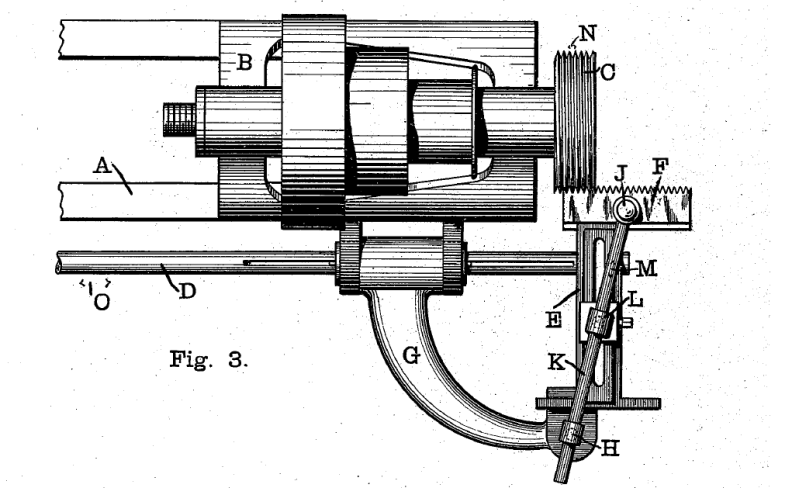

    A 122 year old patent that shows a mechanical variable feed for use with the chase screw cutting system.
    The patent with explanation of the system-
    http://www.google.com/patents?id=Ped...page&q&f=false
    Patent images showing the mechanically variable feed system used with the master thread-
    According to the patent info, the system will allow any pitch less then the master to be cut. So in theory a 10tpi master could cut 10tpi and all pitches below by the setting of the lever position.
    I can envision how it all works and the mechanics seem sound, but I'm no engineer. Anybody have any thoughts?
    Does anybody have knowledge of the variable feed system shown in the above patent ever being used on any lathe or other type of machine?

    Not that I am in any condition to judge at the moment, but one question jumps out at me.
    Why would you be limited to pitches "below" the pitch of the master? Seems to me the fulcrum could be set to allow pitches both greater AND less than the master??

                This is how I read it and it seems to make sense the way the system is shown in the pics .
                Assuming that the parts are so set that the sectional nut occupies its position of midstroke, and that the sliding rod is consequently
                at right angles to the nut and chasing-bar, and that the pivot L is so set upon the T
                shaped arm that the distances from L to J and from L to H are equal, then ifc will appear that for each unit of distance moved by the sectional nut in a path parallel to the axis of the lathe-spindle the pivot L, and consequently the chasing-bar, will have moved one half such distance, and that this proportion of movement will hold good throughout the travel of the sectional nut in either direction. Under such circumstances the chasing-tool controlled by the chasing-bar will have been able to chase a thread whose pitch would be one-half the pitch of the hob.
                It will now be readily understood that the pivot L may be set at various points along the T-shaped arm, and thus permit of the chasing of threads of various pitches by the use of a single hob, it being understood, of course, that as the pivot L is an intermediate pivot, all threads chased will be of less pitch than the pitch of the hob.
                So which is it guys?
                The half nut is much longer than the master thread and slides in the stationary T holder. Unlike the short halfnut that traverses a long master thread as used in the change gear system. So it seems to me that the length of thread that can be cut should be equal to the change gear method.
                    Note even close. First, the rack bumps into the cone pulleys. Second, while you can make the rack any length you want if you overcome the previous problem, provide supports for it along its length, and allow many extra feet on the end of the lathe for the rack to protrude, the lever is short and limits the total length of the thread you can cut. And it will get very ungainly and lack rigidity if you try to also make the lever many feet long.

                              See, I told you I was in no condition to judge.
                              I missed the " pivot L is an INTERMEDIATE pivot" part, which would certainly preclude cutting any pitches coarser than the master. I had the anchor and the sliding bar mixed up.
