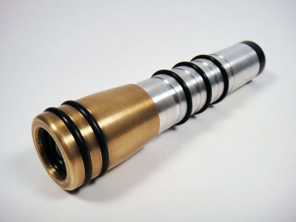

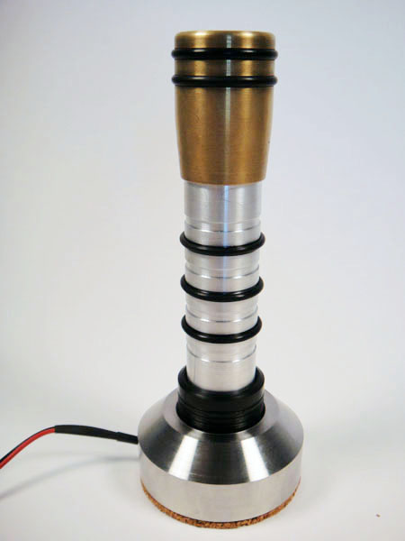

    Hey all, I've been playing around with making some LED flashlights. Here are a few pics. This one uses an 18650 type rechargeable li-ion battery. I decided to get a little crazy and make a charging stand as well so I don't have to remove the battery from the light.

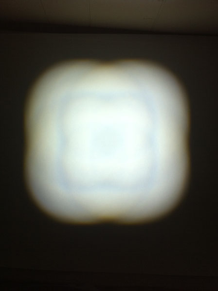

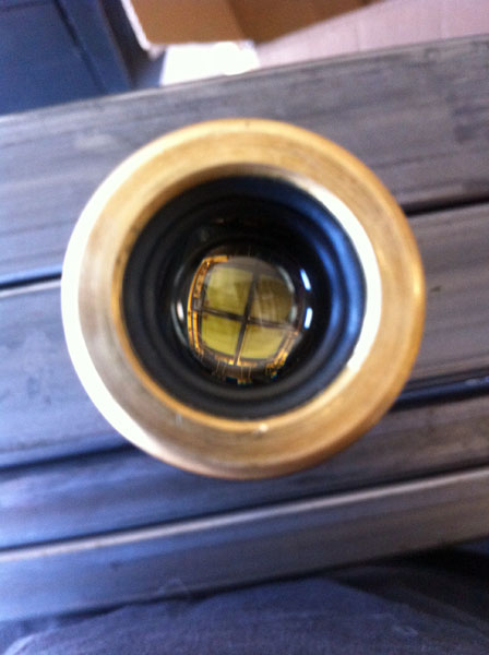

    Here is a shot of the Cree MC-E LED. I'm using an aspheric lens instead of a reflector. The 4 die LED makes kind of a weird square pattern when used with the aspheric, but it's actually growing on me.

        Some more specs:
        battery- 18650 (2600mah) from batteryspace with an additional PCM protection circuit board that prevents over charge/discharge (from BS as well)
        LED-Cree MC-E...forgot where from but they are readily available. It's supposed to put out 750 lumens at 2.8 amps.
        Driver board- 3 mode, low/med/high 2.5A max from shiningbeam
        optics-there is an insane amount of optics out there but this particular build uses a 21.5mm plastic aspheric lens from dealextreme
        That's the main stuff. The rest is just machining

            That looks both fun and useful. How hot does the head get when left on hi for a while? I suppose you'd have cut fins on it if it were a problem, eh?
            Southwest Utah
              At 2.5 amps the head gets fairly hot but the brass is good at moving the heat. At normal room temperature it never gets too hot to touch, but it might keep you from freezing to death in a winter storm...although only for an hour or so It's about maxed out in terms of ability to dissipate heat, but yeah, fins might help. Not strictly "necessary" in this form factor.
              Run time is about 60 minutes on full throttle. Medium is something like 1A and that will last for 2.5 hours and low is 140ma...and that will last forever.

                  I also like the o-ring trim. Have you considered a version with a squared off head? Maybe a triangle or double flats etc to keep it from rolling? You could still use the o-rings.

                      How did you choose the focal length of the lens and etc?
                        Any all all suggestions welcome! I'm going to be making some different versions of this, so it will be fun to have some different things to try out for the shape and detailing. Evan, you are speaking my language. I've always wanted a 45 thousand dollar flashlight
                        As far as the shape, I had no plan, or drawings for that matter. I just grabbed some scrap and went for it. I'm not awfully worried about the thermal dissipation (in terms of brass) but you are correct, aluminum would be better. I like the brass though. It gives it some heft and I think it looks swanky.
                        Oh, and yes, it's 5.25" long. I'm impressed that you can tell! It's a twisty as well. My latest version actually has a tailcap switch instead of the charging port. Just trying some stuff out. I have to say, I like the switch better than the twisty. I suppose the next challenge is to integrate the switch and "stand up" charging.
                        On the optic, I guessed. I made a little clip so I could hold the LED on bench while it was connected to a power supply. Then I started stacking o-rings on top of the led and then sat the lens on top. I found that "3 o-rings" gave me the right out-of-focus condition I was looking for. So I bored the head that deep and made a little delrin stand off that fits over/around the LED to hold the lens at the right distance.
