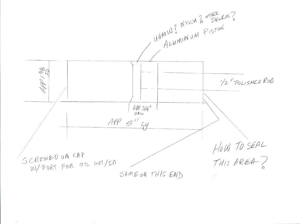

    Looking to make a small cylinder similar to the one shown to set the feed on a smallish saw (app 7" x 12"). 4" of stroke should be enough. The questions is what to use as seal on the piston and what to use to seal the shaft entance to the cylinder. I have a couples sizes of DOM tub that can be honed ( the one ithat I checked was very round on ID at both ends.) the valve I'll post in separate thread.

              Nelson,
              Thanks for the reference to SC. I may go that way of it proves too difficult to make but I already have all the material as scrap and the "can it be done factor" must be persued first.
              Drmico60,
              Very creative. I use a similar flapper arrangement for a 4" ID PVC raft pump.
              Maybe I'll go with an oring for the seal on the piston.
              Here is what I was thinking for the valve. They may aready be made this way for all I know (I've never dissasembled one), but if not I think it should work.
              What does the panel of experts say say? FYI flow shows through adjusting rod but would actually flow along side it. The questions are numbered below.
