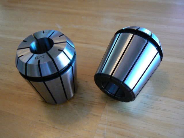

    This is the workholding device that I required for various needs, in the form of a packaged set:
    The set consists of a NMBT-40 (similar to CAT-40) collet chuck, locking nut and spanner wrench plus a set of ER40 collets from 1/8 inch to 1 inch diameter in 1/16 inch increments. I received the shipment a couple of nights ago and finally got around to removing the individual parts from their sealed-in-oil plastic baggies. The Chinese manufacturers have improved greatly over the past two decades in their manner of packaging and preservation, especially for small parts. (Machinery is a slightly different proposition, the use of a gummy protective coating, applied liberally to near-inaccessible areas is a source of frustration when trying to clean and lubricate a new machine.)
    These parts cleaned up nicely in a plastic bucket of mineral spirits with a soft cloth, and they look great ! Except for the spanner wrench, the external surface of the locking nut and the large driving ring on the NMBT-40 chuck every surface is ground (all of these parts appear to be forgings, black-oxide coated, by the way). The fifteen collets are likewise ground on all surfaces except for the rear and the thin slots on each collet that allow the devices to collapse over a wide range. The number of slots varies, depending on collet size, from sixteen down to twelve on the very smallest collets for obvious reasons.
    It is because of the many slots (and the fact that the collets are slotted from both the face and the rear) that these devices have come to be greatly appreciated for their precision, gripping power and the ability to accommodate a wider range of diameters than any other collet device except for the steel-blade-in-rubber-bushing types like those found in tapping heads. Here is a close-up photo showing front and rear of typical collets:
    Most popular workholding collets (e.g. 5C and R8) have three, sometimes four slots and the useful range is the nominal diameter minus perhaps .001 or .002. The reason is simple: larger workpieces "spring" the collet tapers outward and they no longer fit the spindle taper properly. Smaller workpieces achieve only line contact along the center of each individual "finger" of the collet rather than the desired area contact. The accuracy is slightly degraded by this condition but more importantly, the gripping power is reduced substantially and there is risk of permanent damage to the collet if the drawbar is torqued excessively to provide more grip.
    After looking around for a while, I formed the impression that ER collets seem to be more widely used when spindle horsepower is greater than around 2 HP. The various "ER" series of collets with their many more "fingers" to hold the workpiece, maintain a tighter grip over a wider range of workpiece diameter. Frankly, I'm no expert regarding these collets but I have read that they are capable of accommodating a diametral variation of 1/16 inch (imperial sets), which suggests that 1/16 increments should be able to grip any diameter between the minimum and maximum collet diameters, provided that the workpiece isn't tapered. Here is an intentionally exaggerated sketch of the two types of collet construction:
    The diameter of the workpiece and the diameters of the collet "fingers" are identical in both sketches. Notice how much greater the gripping area of the second collet has become by doubling the number of slots and narrowing the fingers. And because the individual fingers are more flexible, they can accommodate greater deflection and therefore greater variation in workpiece diameters. (The actual ER-40 collets have even more slots thus greater flexibility and gripping power.)

        I have run ER's TG100, R8, B&S, Rubberflex, and MT collets, and they all work to some extent. I prefer TG for tough work.
        Using a collet to drive a 3 inch or larger keyed cutter on an arbor, is a poor choice.
        The cutter will at some least wanted time, get hung/overloaded/clogged.
        The arbor will then spin in your ER WUNDER collet, taking the collets precision with it. While spinning the feed is still moving, bending arbor or taking off more teeth/breaking cutter. Also possibly bending collet out of shape...
        Collets are one form of toolholding, not the ONLY form.
        A under $50, NMTB 40 1in or 3/4in endmill holder, would allow you to also use a flat (weldon style) on your arbor stub. And 1 in end mills, boring head shanks, etc. The end mill holder will also give you a lot more vise clearance without the clunky collet nut in the way.
        The amount of runout on a typical milling machine saw cutter mounted on an typical arbor is a bit amazing..

          Thank you for your comments, Bgun.
          I don't recall suggesting that collets were the ONLY form of toolholding. I do have some NMBT-40 tooling and I'd love to have a full set of NMBT-40 stub arbors, shell mill holders, end mill holders, and so on. That's NOT going to happen - I don't support a family with this machine.
          The machine (and the workholders) are not required for heavy work since I am a home shop machinist, as the forum title suggests. This post (and ALL of my posts) was intended for those who share my interests and do not own multi-horsepower machinery OR the budget for an extensive tooling inventory. I don't doubt that, for your needs, ER-40 may be a "poor choice" but CAT-40/ER-40 collet tooling systems seem to be very common in 2 - 3 horsepower production machinery - just a personal observation.
          The tooling that you recommend is exactly what I didn't want - that was the point of the last couple of paragraphs of my post. Collet-held tooling is easy to make and completely adequate for my needs and probably for those of us for whom this is a "hobby". Industrial tooling is expensive and I do not have the option of deducting it from my self-employment tax.
          Randy C

                            First - the post evaluated the ER-40 system, rather than the afterthought of being able to quickly and inexpensively make an arbor for a special purpose.
                            However, since the arbor is now part of the topic, the sketch depicts a shoulder on the arbor that prevents the arbor from being forced into the collet (should the arbor not be bottomed against the drawbar). Spacers are always installed between the collet face (or any other toolholder) before a cutter is installed - otherwise the table can't be cranked close enough to the column for effective work. The spacer provides the shoulder function that prevents movement of the cutter.
                            I'm not getting the "pull the arbor out of the collet" thing. The ER-40 system offers a major improvement over other systems: dual tapers, front and rear. But perhaps that's not what you refer to - insofar as any other mechanism that would produce that effect, maybe I didn't emphasize adequately the point about being able to support the arbor by "choking up" ?
                            That was the entire idea of making short arbors. The overarm not only supports the free end of the arbor but also applies adequate axial pressure to prevent movement of the cutters (note the thrust washer in the sketch). Perhaps all horizontal milling machines don't include the features of my small machine.
                            I also don't get the "loosening" of the ER nut during operation - the only effect that could do so is the inertia of the nut - IF the spindle was reversed at some very high speed which is definitely not within the capability of any machinery that I own, LOL. (Check out the recommended tightening torque for ER-40 systems, as a matter of interest.)

                              Thanks, for explaining and that is a good point. NMBT-40 end mill holders are great toolholders and it would be fairly simple to make 3/4 or 1 inch toolholders to fit a single holder ... but the ER-40 set works on THREE different machines, provides good performance and is very cost-effective.
                              The system covers 90% of the range that I normally require with LOTS of holding power. I can grip any particular piece of scrap (or the two or three diameters of OH drill rod that I keep around) used to make a temporary boring bar, reamer, angle cutter or whatever ... don't have to turn something to a specific diameter to accomodate the single NMBT-40 end mill holder that I own.
                              Randy C
                              edited to add: regarding Bguns comment, that little milling vise isn't a normal feature on the horizontal - there are a pair of substantial moveable jaws normally mounted on the table that don't have the drawback of the small vise (regarding the overhang).
