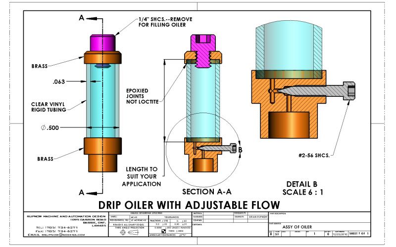

    I have been wanting to build a couple of oilers for my Kerzel engine, and today was the first chance I got to think about it very much. I want to be able to control the flow of oil, shut it off when the engine is setting idle, and have them easy to fill. I didn't want to use Loctite because it apparently will damage the clear vinyl tubing. I already have a couple of #10-24 shcs. drilled out and acting as bearing retainers/oilers on the engine, so these will Loctite onto the head of the screws. (Loctite won't damage the metal, only the clear vinyl) These plans are very adaptable to any engine, and the fact that there is some very definite control for the oil flow, and a way to shut it off if required are a bonus. If you like these plans, feel free to download them and use them.---Merry Christmas.---Brian

    Here is the most innovative part--the base with the holes for oil flow and a needle valve.
    Design engineer
    Barrie, Ontario, Canada
      The cap----
      Design engineer
        And of course, the needle valve. (I've got to get rid of that box of 100 #2-56 screws somehow!!!!)

            Brian,
            I like your fine drawings!
            Thanks for sharing.
            One thing that nags me is an absent small breather hole on top.
            But one that's shielded from debris foul-up.
            Oil out means that air must be able to come in!
            Kind regards,
            Danny

              You might want to put a small air hole down the center of the screw. Also replace the top screw with a brass thumb screw and it might look better.
                Two questions:
                One: How do you start/stop the flow of oil? If you use the needle valve, you have to remember how many turns to open it each time for the flow rate required.
                Two: How do you allow air into the chamber to replace the oil as it drips out?
                (These two things could be combined into a single valve at the top)
                  Now, ain't that as cute as a bugs ear!!! I didn't have any short 1/4" shcs available, but will shorten a couple of long ones tomorrow. The needle valves work, tested by the old "blow your guts out method" while opening and closing the shcs that is now a needle. JPeter---I will assume that was a serious question.---No, its not important to see it dripping, in fact you can't. Those clear tubes are reservoirs to hold the oil while the engine is running.---You can see when the oil is running low and add more through the hole in the top where the 1/4" shcs goes. They look good on the engine, but time will tell if they are a true advantage, or just something to get bumped and knocked off.

                    Two questions:
                    You start the flow of oil by opening the screw 2 full turns. If you don't remember, you have the opportunity to get some machining time in making a new crankshaft---that will stimulate your memory. You stop the flow of oil by turning the screw back in 2 full turns, but if you forget that, the consequences are not so dire.
                    How do you allow air into the chamber??? Damned if I know, I never built these before. I would think that with the vibration of the engine, and the fact that you don't torque down the 1/4" shcs., it will pull enough air in around the screw threads. If it doesn't, then drill a 1/32 hole through the filler screw.---Guys. every design is a prototype. Feel free to make any mods you see necessary.---Brian

                      If you want to get all fancy about letting air in while blocking debris, you could use a vented shcs and a felt plug in the socket. McMaster can fix you right up!
                        Here's a selection of oilers that Debolt sells: http://www.deboltmachine.com/id6.html
                        We use the ones that are closed on the top, there is NO air vent. "Somehow" the oil is drawn out and into the bearing; I've noticed that a looser bearing will use more oil than a tightly-fitted one. We used OilLite bearings on our engines, so running out of oil wouldn't be a disaster anyway.
                        Note the cylinder lubricators at the top of the page: they have a needle valve to adjust flow and a check valve to prevent combustion pressure from puking all the oil out of the top when the engine fires. If the check valve leaks ever so slightly, the oil will become cloudy from the entrained air. You have to make a mental note as to how far to open the needle valve, and you have to remember to close it when you shut the engine down or the oil drains out rather quickly.
                        Brian, your oilers look like they should work well for your application.
