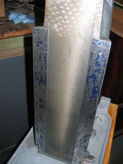

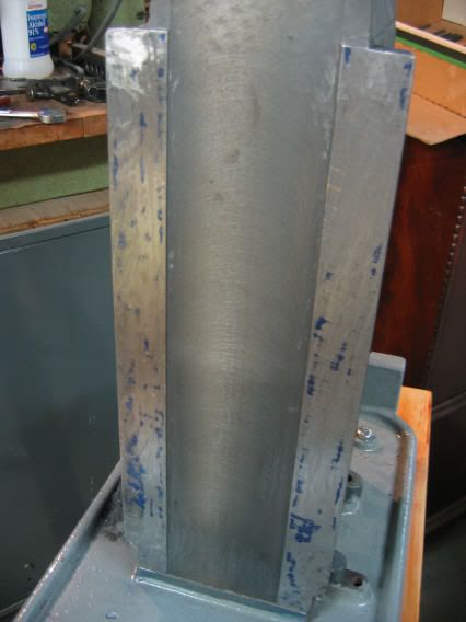

    Got some time to work, and am starting to get some more contact on the column way fronts....
    As-received.....
    last spotting... still plenty to do
    I've been alternating the small granite flat with a straightedge, both "X" and along the length. it was considerably "out".

            For this column, I want to go for the "diamond pattern frosting", we'll see how it goes..... I just love that "Brown & Sharpe catalog" look. I THINK I know in my head how to do it, and we'll see if I can translate that into muscle movement..
            But the alignments have to be right, I want it right even if it doesn't get "frosted". Now I need to dig around for my longest parallel so I can start checking the alignments as I go. The basic marking is now just about all over the surfaces, so it is refining time if it shows up within spec.

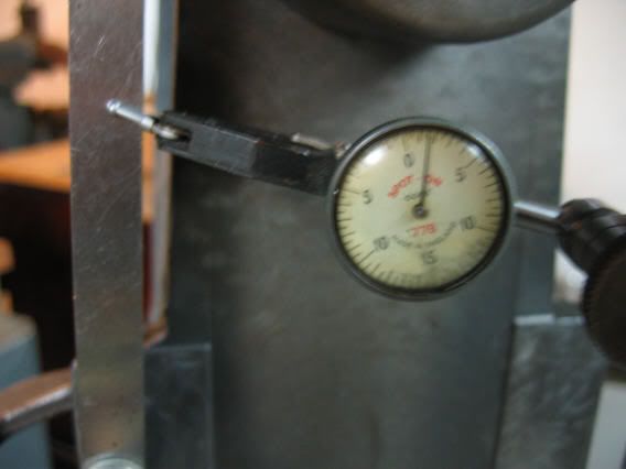

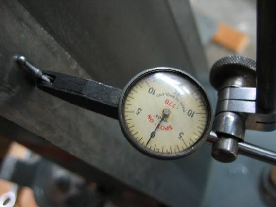

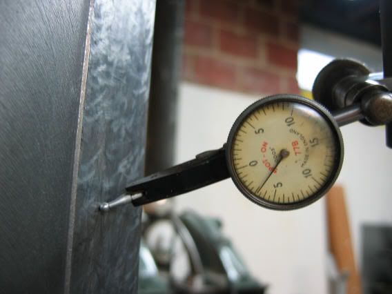

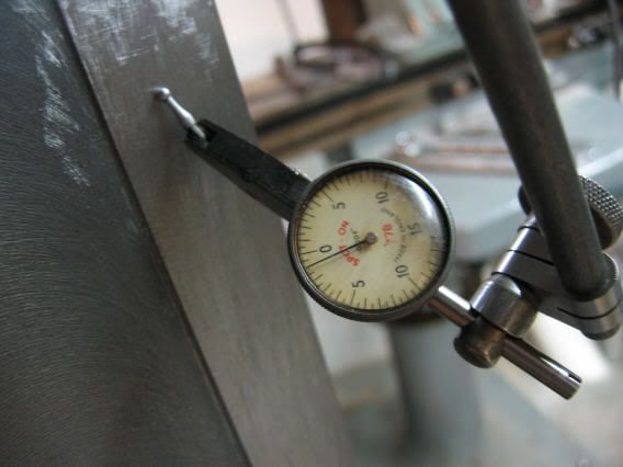

              Well, since I got to a place with a decent flatness, I could test the ways for alinement to the spindle.
              Setup #1
              left side
              Right side
              Clearly not good, I'll have to scrape a lot off to get this within my goal, which is around 0.001 or less. It's around 7" across the ways, and I want no more than 0.002" in 18" error. So a bit under 0.001 should do it.

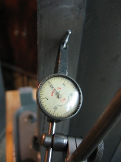

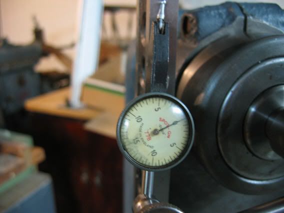

                Now the vertical alinement, using the best parallel I can find of a decent length. Could be longer and be better, but I haven't made that part yet.
                Setup
                Upper check
                lower
                looks like some work there also, I'd like that nearly dead-on, since the same 0.002 per 18" applies, and the length of measurement was not so long.
                So it's off to scrape the right side heavy, and the tops of both heavier while taking a bit off the right side of teh left way, to allow the plane to turn a bit to the right.
                  So, now quite a bit of scraping has been done.... taking off just a couple thou is a lot of work, actually,. Makes me laugh when I see someone afraid to use oil and abrasive paper to clean rust off ways.
                  Left side
                  right side
                  Not so bad. if I do the right one heavy and left light as I flatten them, should come in. I'm not going to measure the vertical until the flatness improves.
                  Spotting, just to see where we are.
                  Hmmmm work to do.

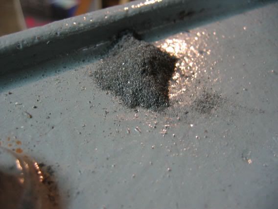

                  Just for grins, here's the pile removed , most all from right hand side, in bringing the way down 0.002 or so.

                        Not owning or having read MTR.... What do you have mounted in the spindle to clamp the test indicator to? If that's a commercially produced MT stub or drill chuck arbor, can you be certain of its concentricity? How can you be certain that the spindle bearings aren't affecting your indicator reading as you rotate the "fixture to access the other column way?
                        Just looking for a better understanding of your assessment procedure.
                          1) Concentricity of any part of the holder is unimportant as long as it is steady and does not change when moved. Since I got very consistent readings, it didn't change.
                          2) Spindle bearings (tapered roller in this case) could make a difference, and I checked for that right away. Since this unit has the spindle in a sort of quill, or "carrier", that in turn is clamped to the column, I could unclamp, turn the "carrier", clamp, and re-check. That turns the outer races vs the rollers and spindle. Turning 180 deg in small increments showed very closely similar results at all points, so the bearings were not a concern. I also had the arm off a time or two, and back on at relatively random orientations.
                          Looking at the geometry, the distance between bearings is less than 2:1 vs the longest lever arm. So to create an error of 0.002, the bearing system would have to be "out" 0.001, which is a lot.
                          Then also, the longer lever arm has a very small arc through which it turns in the test, perhaps 1/6 or 1/8 turn. If the bearing system is "out" 0.001 in that small arc, it has an extremely serious wobble.

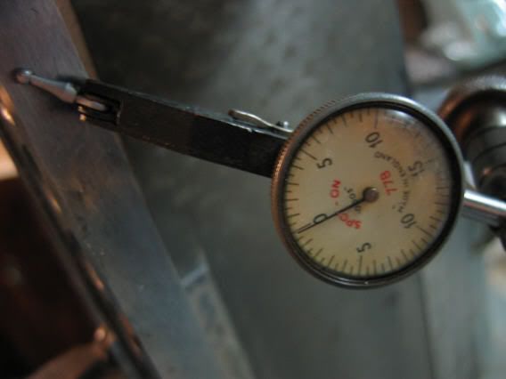

                            Got some more time into this .....
                            latest left side
                            latest right side
                            Not perfect, but within my requirements.
                            I probably had it closer at one time, but ended up overshooting a little on the left way, and had to take off more than I wanted to. Then I was pretty unwilling to do anything drastic on the right.

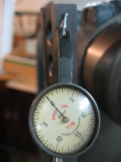

                            latest top
                            latest bottom
                            I'm calling that good......
